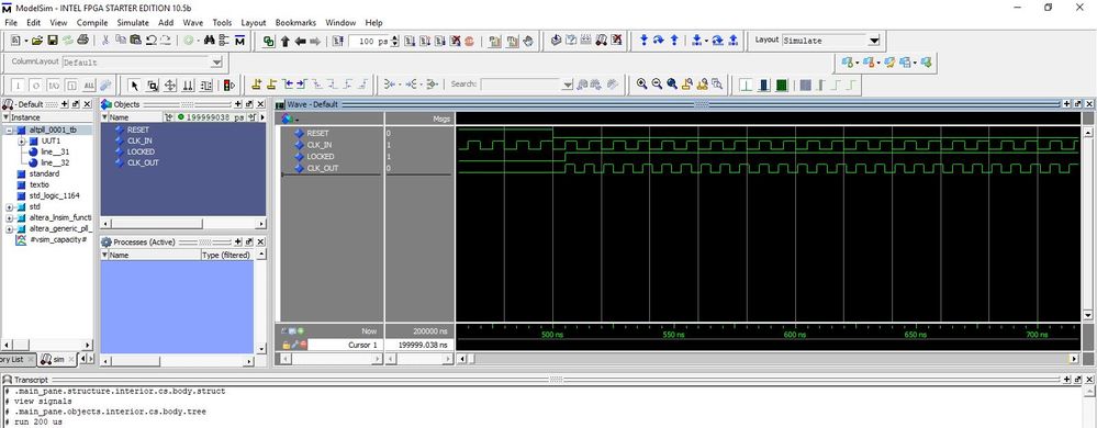

Hi everyone,
I've generated PLL by Quartus 18.1 Lite MegaWizard .(C0,100Mhz-> 125MHz).
Then I've built a very simple project in ModelSim 10.5B with above mentioned PLL component.
But when I'm trying to simulate the project, I'm getting a such kind warning:
 "Warning: (vsim-8684) No drivers exist on out port /altpll_0001_tb/UUT1/CLK_OUT".
it seems that ModelSim cannot recognize a MegaWizard generated component...
What Should I do?
P.S. I've attached a project to this message

AGofs
4,491 Views
Hi Vicky,
I'm not getting desired result in simulation.
The only result is a red line.
You can see it from attached print-screen...
Vicky1
4,491 Views
Can you please check with Native link simulation?
https://www.youtube.com/watch?v=PmVVXQchv2c
this issue may occur when simulation process missing any file or sequence.
Vicky

AGofs
4,490 Views
Hi Vicky,
I've received the project and simulated it.
It works properly.
Now , explain me please what did you change at the code?
Vicky1
4,490 Views
I haven`t changed anything in your project, just performed the simulation using native link settings as suggested in my second post.
As I told earlier, it might happen due to all modules/submodules are not in single directory so here in case of native link script will take care of that.
Should I consider that case to be closed?
Vicky
