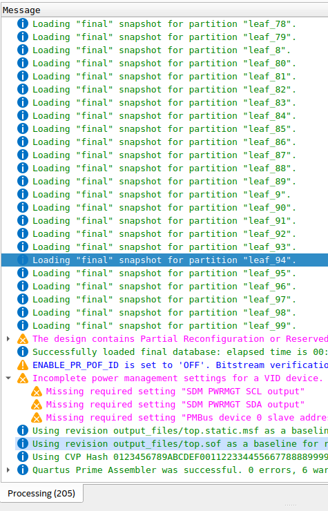

Below is the Message log when I have only 7 PR regions and have ENABLE_PR_POF_ID setting on.
It successfully generates .rbf followed by .pmsf and .sof.
Below is when I have only more than 100 PR regions and have ENABLE_PR_POF_ID setting off.
It has a warning saying that "ENABLE_PR_POF_ID is set to OFF" but this is expected.
Somehow it doesn't generate .pmsf and .rbf.
