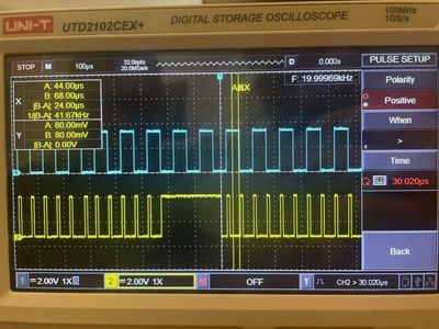

I wrote a code to test the latency of the SOC communication,
the result are as followed:
The blue line is the clock flag I made, it sends the 50us toggle flag to the pio of fpga,
The yellow line is a HPS code that detected edge change of the blue one and did something and show that it is done.
I seldom catch the above result and wonder how to fix that.

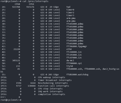

I suspect that it may duel to the Linux system interrupt.(but have no evidence)
The following is the interrupt list of my device
Could you guys figure out why and how?

From your picture, I see is a there is a 100us ++ in ur code detection in Linux application.
May I know it happens sometimes? Is your linux application solely running on a single task just to capture the toggling?

This issue happens several seconds, I can't tell you the precise time but it seems will happen in a fixed time period.
And yes, my usersapce code only do the detect signal, count a number to 1000 and send the job done signal.

I see you have disabled the timer interrupt call in your code.
Do you mean if you use interrupt to call a function to set the changes of the output signal as indicator(observe on the oscilloscope) then there is no issue? But if you use while loop then there will be issue?
If I am correct for the below:
  1. Your polling method is using a while(1) loop.
  2. Everytime the clock signal edge(low->high) happened, there will be changes on the timer register which you will check within the while loop. Your output signal indicatoer will go high when it happened.
  3. Everytime you call the myfunction(), it is going into a for loop to perform counting. which creates a short delay that meant for the output signal indicator to go low again.
  4. your output indicator signal is taking longer time than usual to change from high to low.
  5. It looks like sometimes it is taking a longer time when running the while loop.

you are basically right, what my code do is to:
1.check the edge change(high -> low or low->high) of the timer flag.
2.put start signal to 1 and jump to myfunction(),
3.when it is done(and let us cross fingers it is done in time),set the start signal to 0
Well, I didn't succeed in linux interrupt, still trying to figure out how an interrupt communicate with the userspace(and if it is reading/writing to userspace, it need to use another interrupt, I don't wish the timer signal is interruptted).
For this issue,when every edge changed(blue line,which is done by FPGA), a yellow signal(userspace signals) will be 1 and when myfunction() is done it set to 0.
And then repeat the work.
But after several seconds of working progress, the issue will occur, which is an unstable disaster for my system.
So I want to know how to prevent this problem.
Thank you for your help.

The while loop method will not guarantee a consistent timing for sure.
The operation should be done with interrupt.
