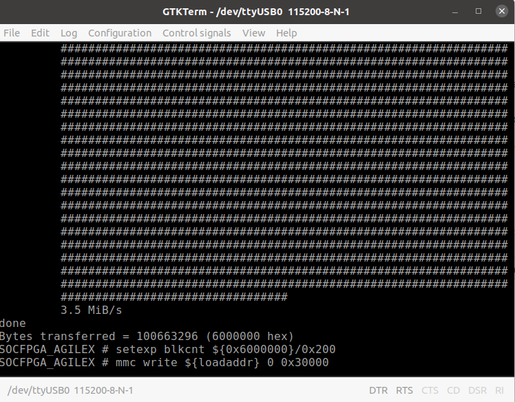

The patch doesn't  work,but i managed to write data in the reserved memory memory[1] region.
And now I stuck in another issue " mmc blocks written = error"
I have attached the error log image and configured load address as 0x280000000.
M Gokulraj

The solution you suggested for problems related in SD-card partition.Here the main issue is in reading 64bit memory address.
"mmc write" command can take 32bit memory address and its is working fine,but while using 64bit memory address it's locked in timeout error. I've confirmed it by debugging the u-boot code while using "mmc write" command.
will you check with the file related to mmc in driver and include folder in your side and give me a solution.

Could you try make the changes to the files in your uboot as shown in the image below:
