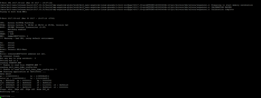

Error imgError imgHi,
Actually, My requirement is i need to boot my DE10-nano with my customized hardware design for that i followed a document which is recommended by you
in before mail. Using quartus 21.1 tool i generated required files i.e, sof, .dtb, .rbf and so on.
I generated customized bootloader(U-boot) for DE10-nano which configure u-boot to flash fpga automatically at boottime. but i'm not able to generate
preloader so i took that from DE10_nano_xfce standard one and also i took kernal from standard one .With this i tried to boot my De10-nano i gives error.
For your reference i attached an error image.
What may be the problem, please assist me to solve this issue.

First need to confirm if the design example work?

Booting with GHRD design example's .rbf , .dtb, u-boot.img also I'm encountering same error which is mentioned in before post.
Give me one proper document for how to boot the system with customized hardware design.
I followed the below mentioned link to boot my system . It is also useless and also i encountered lots of errors while compiling preload-er, u-boot
https://bitlog.it/20170820_building_embedded_linux_for_the_terasic_de10-nano.html
My requirement is i need to configure GPIO's(0 & 1) for HPS .By default it is in FPGA .
Sharing hardware design files for above requirement is appreciable.

From this design resource:
https://www.terasic.com.tw/cgi-bin/page/archive.pl?Language=English&CategoryNo=167&No=1046&PartNo=4#contents
compare to your custom design, what has changed? If you change the IO, you will need to update the device tree.
