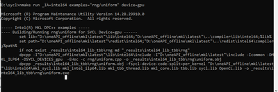

Okay now I've followed the exact same steps using nmake.But I've still got the same issue.The obj file is getting generated but the exe file never gets generated.The command just keeps running and my memory utilization is going to 97%(8GB RAM).I don't know why this is happening.Please help me with the same.

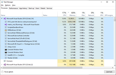

Hi, if I can give an easier simple example of my problem.
Run up VS2019 and create a new project from the oneAPI sample template. Select the matrix_multiply project. Building it takes a few seconds.
Now go into project properties and select 'Intel Libraries for oneAPI', set use oneMKL to Sequential. Now building the same project takes 10's of minutes and the 'SYCL post-link device code processing tool' uses > 10Gb memory.
Surely this can't be correct? All I have done is added oneMKL to the project.

I still haven't been able to generate a .exe file yet.The 3D object file gets generated but the command promt runs forever.My memory and disk usage is at 100%.
I've commented the last line of the makefile as you suggested,but still the issue persists.
My command promt is stuck at the above screen.Please let me know if this problem is due to the compiler as mentioned in the github readme,or am I going wrong somewhere.

Hi Ayush, this was the exact same problem I was having.
The sycl cl linker was taking most of my resources and over 40 minutes to link - if you have enough resources and patience it will probably succeed.
I have 8GB RAM with Core i5 8300H 4.0GHz. Not sure if processor matters here.I left it for an hour but no compilation yet. And during that time my PC was unusable because of less available RAM
Hi Ayush, I have an older 8 thread i7 running @ 4.2GHz with 32Gb RAM. The RAM was the limiting factor and sometimes I even ran out and the linking failed.
The DPC compiler is unusable from that point of view until they fix the bug which is a real pity since I was really interested in trying to gain an understanding of OneMKL on GPU
