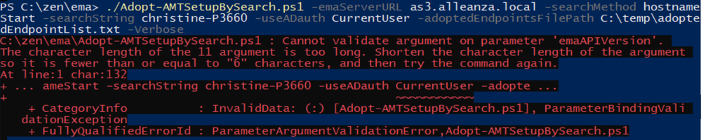

So, I have tried using the Powershell script in the hope that this would populate the Managed Endpoints in EMA.
.\Adopt-AMTSetupBySearch.ps1 -emaServerURL as3.alleanza.local -searchMethod hostnameStart -searchstring Brendan-P3660.alleanza.local
Where
as3.alleanza.local = fqdn of EMA Server
Brendan-P3660.alleanza.local = fqdn of workstation
Output from script:
Invoke-WebRequest : The underlying connection was closed: Could not establish trust relationship
for the SSL/TLS secure channel.
At C:\zen\ema\Adopt-AMTSetupBySearch.ps1:195 char:24
+ ... { $token = Invoke-WebRequest -Uri "$emaServerURL/api/token" -UseBasi ...
+ CategoryInfo : InvalidOperation: (System.Net.HttpWebRequest:HttpWebRequest) [Invok
e-WebRequest], WebException
+ FullyQualifiedErrorId : WebCmdletWebResponseException,Microsoft.PowerShell.Commands.InvokeW
ebRequestCommand

The steps we previously provided work on our end; therefore, please try them one more time making sure each step is completed accordingly:
1-Go into MEBX and under Intel AMT Configuration, Network Access State choose Network Activate (Note: The language may vary slightly from OEM to OEM. We used a Lenovo in this test).
2-Also, you will want to change user Consent in MEBX to NONE. This will allow you to do OOB KVM without any user interaction.
3-Next, you will want to set up a profile with CIRA mode and other desired settings. If you already have a profile with CIRA or TLS with the settings if you prefer you can skip this step and just create an endpoint configuration and associate the profile to it.
4-Create a new adoption end-point.
5-Enable AMT autosetup and choose the right profile.
6-Since you don't have a cert he will need to choose HBP (Host Base Provisioning) and also don't use a randomized password but one you can remember or document. It is ok that you use HBP in autosetup because it doesn't overwrite what has been set in MEBX. That said if you use this endpoint configuration on a new system that hasn't been set up in MEBX by choosing activate network then it will be provisioned into CCM NOT ACM.
7-Proceed to download the EMA API. You will use the adopted scripts to pull the endpoint into EMA.
https://www.intel.com/content/www/us/en/download/19693/intel-endpoint-management-assistant-intel-ema-api-sample-scripts.html
8-Install the EMA agent onto the laptop and it should show in the EMA WebUI and provisioned into ACM. However, it will show as provisioned by another tool. That is because it has already been provisioned manually in MEBX.
9-The easiest way to adopt a single system is to use the Adopt-AMTSetupBySearch PS script.
While you are running the command please have into consideration the information below:
PS> ./Adopt-AMTSetupBySearch.ps1 -emaServerURL EMAServer.demo.com -searchMethod hostnameStart -searchString laptop -adoptedEndpointsFilePath C:\temp\adoptedEndpointList.txt -Verbose
EMAServer.demo.com: with FQDN of EMA instance
searchMethod: with hostnameStart
searchString: with PC name
When you enter the command and you hit enter a screen will be shown and you will have to enter your Tenant credentials.
Note: The Powershell script has examples in it for future scripting purposes.
10-Bring up Platform Manager and verify if everything went smoothly. Also, verify in the EMA WebUI. The endpoint should have now been adopted in ACM since that was set up in MEBX, despite the auto-setup specifying HBP.
Note: Please remember that there are some domains that are not supported in EMA, .local is one of them, you can see more information on the ones available here  . Please bear in mind that since your FQDN doesn't have a supported domain and cannot be changed after EMA has been installed you will need to install EMA from scratch before attempting the steps above.

VeeDub
6,005 Views
Hello Victor,
I have some "interesting" developments to report.
Today, I sat down with the intention of working through your most recent post to try and either get VPro working or work out where the problem seemed to lie.
I encountered issues accessing the EMA server remotely which resulted in me restarting the EMA server and installing a bunch of updates.
Once I was able to access the EMA server remotely, logged into the EMA portal.
To my surprise, the Endpoint which I had been trying to add on Friday was listed and the status was "Provisioned".
The remote KVM is working.
One aspect which I would like to be able to change is that the EndPoint has two monitors attached. The Desktop / KVM option defaults to 'All displays' (which is fine). But once I select either Monitor 1 or Monitor 2, it then switches back to 'All displays' after 1 - 2 minutes. I would like the Display option to remain on the one that I select. So for instance if I choose: Monitor 1, then I want it to stay on Monitor 1 until I make an alternative selection.
So, apart from restarting the EMA server (3 or 4 times) and installing Microsoft updates; I have not performed any of your most recently suggested troubleshooting steps.
Therefore, the powershell script that I used previously, which did not execute properly (clearly wasn't required to provision this Endpoint).
I won't be back on-site until next Friday, at that time I will try to provision more Endpoints.

I have attempted to add more endpoints without success.
In reviewing the previous correspondence I have noticed the following comment
That comment does not make sense for the following reasons:
1. Where a Microsoft Active Directory domain is not connected to the Internet and / or is not meant to be externally accessible; then best practice AD naming standard is to use the domain suffix: .local
.local is equivalent to 192.168 .x.x, 10.x.x.x with regards to IP addressing
2. Despite your comment above, the first endpoint that I added is visible in EMA, so despite your comment it has been possible to add endpoints with a .local domain suffix.
However, the problem that I have encountered is that none of my other endpoints are appearing in EMA, provisioned or otherwise.
Please advise suggestions to troubleshoot.
VW
VeeDub
5,921 Views
Hello Victor,
I also note that the powershell script executes with errors, so that would probably be the place to start in terms of troubleshooting (i.e. resolving the errors so that the powershell script executes without error).
Vaughan

This is what I see when I try to run the Powershell script
The file: C:\temp\adoptedEndpointList.txt is a 0 byte file.

Hello VeeDub,
Thank you for your responses.
The reason you need to fully unprovisioned the two endpoints you have showed us is because from what we can see non of them are working properly. Brendan-P3660 is showing as provisioned but CIRA appears as not connected for it; therefore, there is no KVM management for it, and Christine-P3660 is showing as provisioned as well but is not being recognized by EMA, in other words, despite being provisioned both endpoints are not properly configured.
In regards to the command I apologize the ones previously provided were meant to be used for other scenarios the one that you need to run once each endpoint has been unprovisioned is the one below:
PS> ./Adopt-AMTSetupBySearch.ps1 -emaServerURL EMAServer.demo.com -searchMethod hostnameStart -searchString laptop.

Hello Victor,
I do have KVM management for Brendan-P3660.
The Powershell script still isn't working.
VW
Victor_G_Intel
5,670 Views
Hello VeeDub,
We appreciate your response.
Your command’s Syntax seems a bit wrong, please use the one below.
