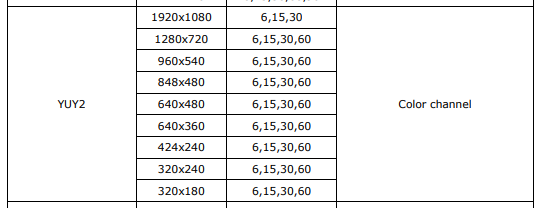

According to the datasheet of D435 (https://www.mouser.com/pdfdocs/Intel_D400_Series_Datasheet.pdf), D435 should support 60FPS well on resolution 640*480.
Thank you,

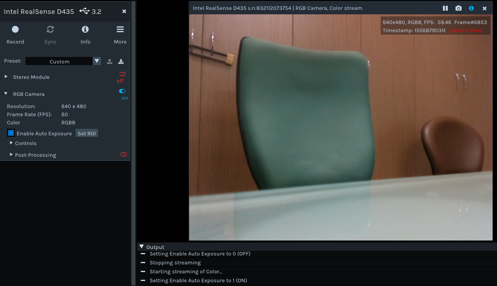

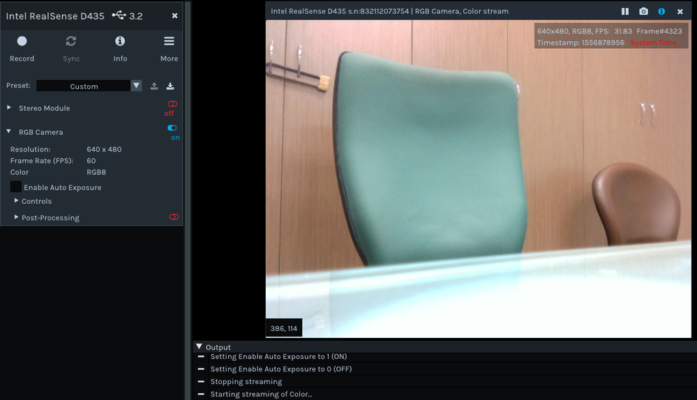

擷取2.PNG擷取1.PNGIt's strange that when I enable auto exposure, the fps can reach 60 fps.
When I turn off auto exposure, the fps will drop to 32 fps.
