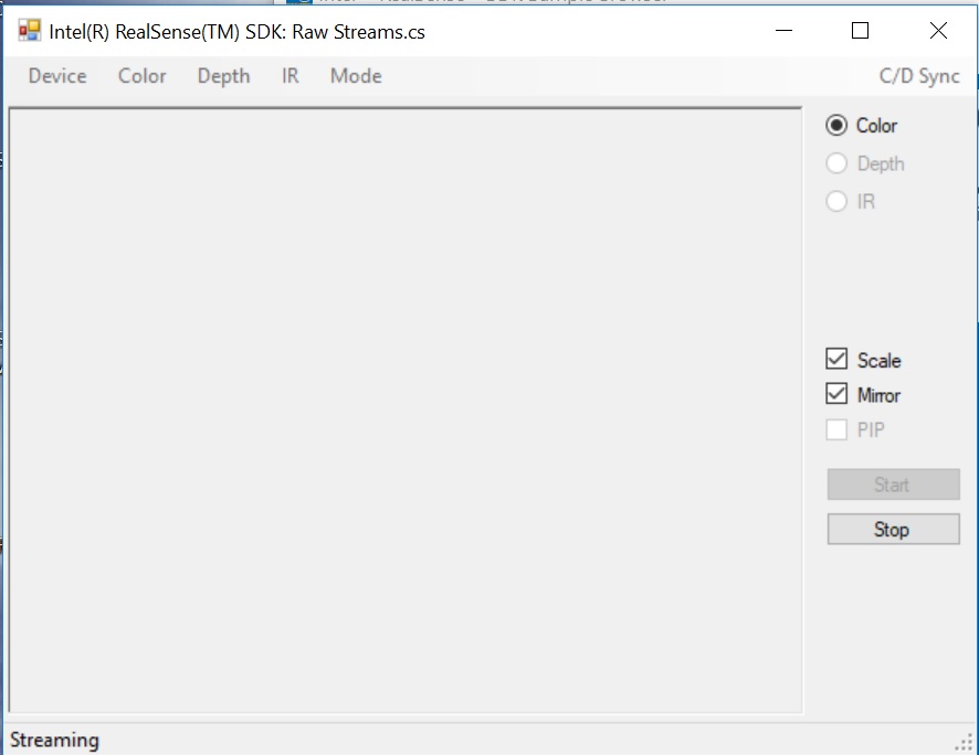

Hello. This does not work. Neither the workaround posted by Slothameedees nor the update by shanister and also not the additional info provided by BiqGames.
I went through an seemingly endless loop of uninstall and re-installing the camera. I even did a complete fresh installation of Windows. I now ended up having these drivers:
Intel(R) RealSense(TM) Camera SR300 Depth - 3.3.27.5718 as of 2016-09-22 by Intel(R) Corporation
Intel(R) RealSense(TM) Camera SR300 RGB - 10.0.15063.0 as of 2006-06-21 by Microsoft
Intel(R) RealSense(TM) Camera SR300 Virtual Driver - 12.11.38.553 as of 2016-06-08 by Intel
Windows Hello does work, but NO other software can access the camera (i.e. no Skype, not the Windows Camera App, no OBS, even not the Intel Camera Explorer from the RealSense SDK). All other programs say that the camera apparently is in use by another application (it isn't, and the camera is also not active - no green light).
I'm a bit annoyed. I bought this really expensive camera, and now the only thing it can do is to log me in to my computer. And not remove the background for streaming, what is what I actually bought it for and also not capable of doing simple RGB pictures or videos, which is most annoying as I rely on Skype quite a lot on my job.
