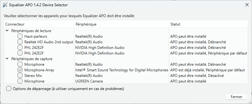

Hi @YasinAlbayrak, I may have a temporary fix for you. I uploaded it on Microsoft Community earlier and it seems to be working fine.
Here it is. Let me know if it helped!
1. Download and Install Equalizer APO
2. Enable Equalizer APO on the Microphone
  • In the Configurator, go to the Capture devices tab.
  • Find and check the box next to
    "Microphone Array (Intel® Smart Sound Technology for Digital Microphones)".
  • Click OK, then Finish.
  • If prompted, reboot your computer.
Note: If the microphone does not appear in the list, make sure it is enabled in Windows sound settings and properly connected. You can select the device after the Equalizer APO installation by launching the “Equalizer APO Device Selector” app.

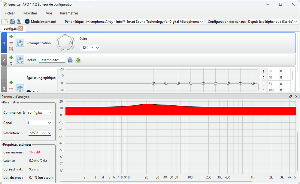

3. Increase Microphone Gain Using the Configuration Editor
  • After the reboot, open the Equalizer APO Configuration Editor from the Start menu.
  • On startup, you may see a message like
    "Equalizer APO is not installed on the selected device."
    This is expected, because the default selection is often an output device (e.g., speakers).
    Click "No" to dismiss the message.
  • At the top, select
    "Microphone Array (Intel® Smart Sound Technology for Digital Microphones)" from the list of devices.
  • In the main panel, add a Preamp block (use the "+" button or right-click).
  • Set the gain to +12 dB. You can adjust this value as needed (between +10 and +20 dB).
  • Go to File → Save to apply the configuration.
This will boost your microphone’s signal in most Windows applications.
4. Adjust Discord Settings if Needed
Some applications, such as Discord, may not reflect the gain increase automatically.
To fix this:
  • Open Discord → Settings → Voice & Video.
  • Scroll to the Audio Subsystem section.
  • Set it to Legacy.
  • Restart Discord.
