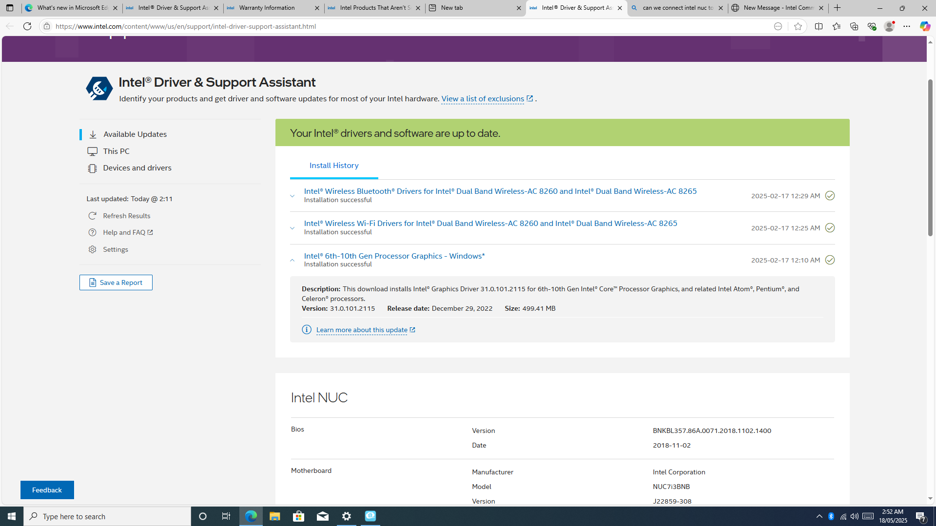

unable to connect sony 50inch XL smart tv with intetl nuc Model:NUC7i3BNK machine. first time screen came then goes off ,looks as some compatible issue with screen. all display and graphic drivers are update from intel screen shot attached. expecting your immediate attaention

The latest driver package for your NUC is version 2135, which you can download from here: https://www.intel.com/content/www/us/en/download/776137/intel-7th-10th-gen-processor-graphics-windows.html. Give this package a try and see if it alleviates the problem. Let us know what happens.
