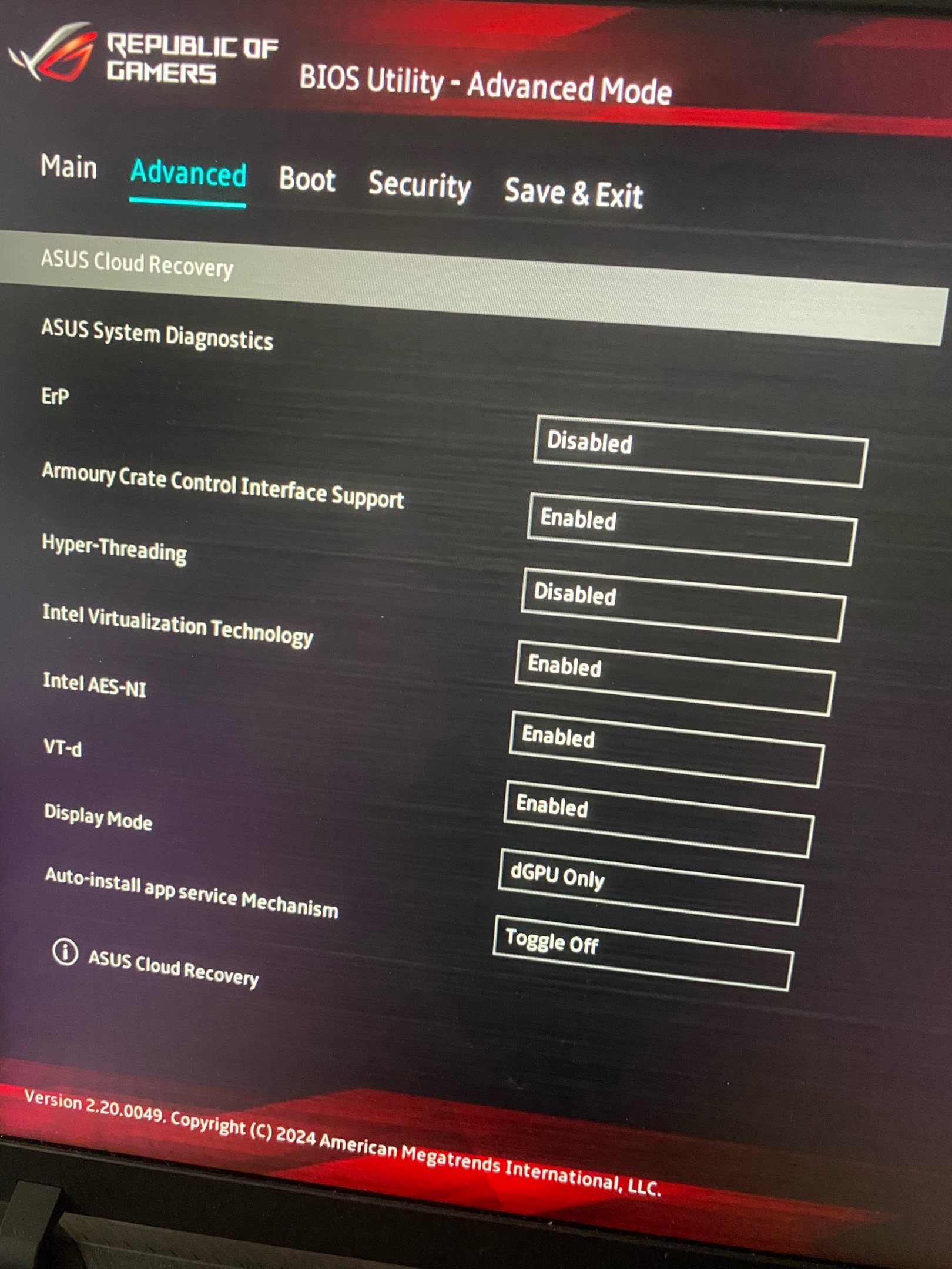

i have update to latest BIOS 328 but problem still exist
In BIOS i can't change any related with CPU only enabling/disabling hyper threading
with enabled hyper threading problem CPU 10
with disabling hyper threading problem CPU 5
i manage CPU via special software - process lasso
video demonstrating the problem https://www.youtube.com/watch?v=GeQEQ2ETum4

This is like the 14900k i had...
What you wanna do is RMA, the CPU is without doubt defective like everyone else's 13900K/14900K. Try to get an exchange or refund too since the problem will probably keep coming again.
If it does it even without hyperthreading it means the CPU core has become degraded enough not even disabling hyperthreading will help. You can still try downclocking the core that crashes but there is no guarantee the CPU core will not degrade further.

As this is a laptop, our support is limited when it comes to modifying the BIOS settings as this is considered an Original Equipment Manufacturer Device in which we are not familiar with the technology, settings, customizations, custom drivers, and features that the OEM has designed and installed your system.
While it is true that on defective units, we process a replacement as
vmovups mentioned. as this is a laptop CPU, it is highly likely that the CPU is soldered down in the system. This means that you might to ask for a replacement of the whole laptop with your OEM.
However, we are still trying some troubleshooting steps and we have yet to confirm this system as defective. I kindly ask if you can allow me sometime to coordinate this with our team to determine if there are other steps that we can do.
As for vmovups, I am sorry to hear about this experience. If you can allow us to make it up to you by creating a new thread, we will really appreciate it.

Thank you for patiently waiting. After coordinating with our team, I want to let you know that you have already done extensive troubleshooting and we believe your device may require specialized attention. As such, we highly recommend contacting ASUS, the Original Equipment Manufacturer, for in-depth support as our support for OEM devices is limited.
