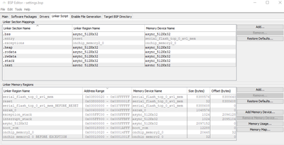

I am having troubles with booting up a Cyclone V NIOS II app from S25FL128SAGNFM001 using Intel GSFI. I am using 22.1 tools.
I tried to follow the https://community.intel.com/cipcp26785/attachments/cipcp26785/fpga-wiki/926/1/Generic_Serial_Flash_Interface_design_example_quick_start_guide_final_updated.pdf
but have no luck. Sorry for a very long post.
Here is the Platform Designer NIOS setup
Here is the Intel GSFI /Flash setup
The NIOS application runs from the RAM and accesses the flash with no problems (for some reason my app reports Control Register = 0x82 instead of 0x101) but I cannot boot it from the flash.
Here are the BSP settings
Here is the mem_init_generate output (only serial_flash_top_0.hex is used)

Hi
I see that your linker setting is wrong in the BSP Setting.
You are running the "Nios II processor application is copied from EPCQ flash to RAM using boot copier" boot method.
Could you change the Linker to all OnChip Memory.
https://www.intel.com/content/www/us/en/docs/programmable/683104/current/bsp-editor-settings.html

Thank you for your reply.
The OnChip memory is too small to copy there the application.
The async_512Kx32 is an external RAM that is used for running the application.
It works since the debugger loads the app there without any problems.

Hi
I this case, you would need to change the exception vector to select the external RAM instead of the on chip memory.
Additional info, if you have spare logic space in the FPGA, you could increase the on chip memory size to fit your application. You could remove the need of external RAM.

BBS3000
589 Views
The issue was due to a missed byte-enable signal to the SRAM so the bootloader could not copy bytes from the flash to the SRAM correctly. We fixed it.
