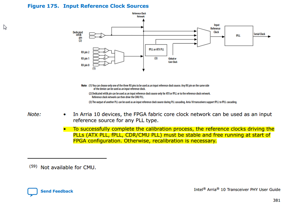

Hi, we are using ​10AX057H3F34E2SG for PCIe GEN3.0 x4 lanes, connected to a PC module by Board to Board connects.
I read on section 7.3 of UG-01143 (Arria 10 Transceiver PHY User Guide, page582) that user need to provide a CLOCK for proper transceiver for power-up calibration, and only Power-ON Calibration are allowed for PCIe..
Question1: Is this CLK refer to CLKUSR or dedicated XCVR REFCLK pin pairs, or both? As marked with red and blue lines in below picture. I guess both CLKUSR and XCVR clock should be provided to FPGA. But still need intel confirm.A10-calibe-clk.pngQuestion2: For section 7.3, what's the specific definition of "Programm" action in first sentence? Does it refer to Configuration, or Initialization, or both? Also, I'm confused that seems to be conflict between the FIRST and SECOND sentence for this paragraph. First sentence indicates that XCVR calibration start AFTER "programmed" , while second sentence indicates that calibration could continue DURING "Programming
", and may extend into user-mode.
How to understand this? I guess the seuqence should be Power on -->Configuration-->Initialization-->XCVR Calinration( user mode in parallel). Not sure......When EXACTLY the calibration begins? Is there timing diagrams on Intel docs?
Question3: To avoid the well-known “100 ms boot time requirement for PCIe”, We decide to power FPGA first, after detect the CONFIG_DONE signal be pulled high, then start PC, then the PCIe reference clock will be sent from PC to FPGA GXB banks.
However, this will be CONFLICT with UG-01143 section 3.2 , page381 note, which writes “To successfully complete the calibration process, the reference clocks driving the PLLs (ATX PLL, fPLL, CDR/CMU PLL) must be stable and free running at start of FPGA configuration”. Do you have any insight about how could we solve this conflict?

Hi @xytech​
Calibration starts during configuration.
No timing sequence, the time for calibration to complete vary by device.
Based on experience, faster configuration time is needed if you are designing for open-system to meet the 100ms. For closed-system, you can adjust the PERST to allow more time.
Hope this helps.

Hi @xytech,
Let me try to help out here.
Q1: Yes, both.
Q2: Calibration starts as soon as FPGA is powered. Cal_busy goes low to indicate calibration completion.
Q3: The 100Mhz refclk for PCIe must be stable before FPGA is powered. See diagram of PCIe spec, FPGA should configuration within point (3). Link training is somewhere within (4).
Hope this helps.

Hi JwChin, thank you very much for patient reply.
For Q2, As you mentioned “Calibration starts as soon as FPGA is powered”. Is it start AFTER or parallel with Configuration Starting Moment? This confusion came from between First and Second sentences on page582 section7.3 of ug-01143 ( as pic in my original post). And Is there some Intel document describes the timing sequence of related signals ?
According to you information, it seems that we have no choice but to change our config scheme from ASx4 to FPP for faster configuration time. Or we might use Partial Reconfiguration or Configuration Data Compression, but it will consume more work for our FPGA staffs.
Thanks again, and look forwar to your discussion.

Hi @xytech,
There are two main types of calibration.
• Power-up calibration—Initiates automatically at device power-up and runs during device configuration.
• User calibration—If you perform dynamic reconfiguration or change the reference clock frequency of the I/O PLL, you must perform user recalibration. You must enable the required calibration sequence.
With that, answer to "Is it start AFTER or parallel with Configuration Starting Moment?" should be parallel with the configuration process.
There is no timing sequence for the calibration process as the time required after device power-up to complete the calibration process can vary by device. That's why you will need the cal_busy signal to know when it completes.
Just my 2 cents, as to ASx4 to FPP, I think it depends the PCIe is used for open-system (need to meet 100ms requirement) or closed-system (up to you to decide). If it is a closed-system, I dont see why you need to change to FPP, you can delay the #PERST to allow more time.
I hope this helps.
As UG-01143 section 7.3 writes, PCIe links do not allow user recalibration. We have no choice. Only can do power up calibration.
OK, finally confirmed that Calibration starts during configuration and no specific timing, cal_busy indicates Calibration completes.
Yes, we do design OPEN-System. Root PCIe node is a standard x86 COMe module (compact PC module), and we cannot control when PERST# will be released.
Actually in our older product, we use Artix-7A200T FPGA of Xilinx, which DO NOT explicitly requires “transceiver Reference clock must be stable and free running BEFORE FPGA powered up for successful XCVR calib”(they do not need CLKUSR neither) , so our system are designed to power FPGA first, after detect its CONFIG_DONE signal released (pulled high), then we start PC module, this made sure PC can enumerate FPGA PCIe node. It worked fine.
Now it’s clear that this solution is NOT suitable for Intel A10. So we must change a fast enough configuration scheme to satisfy PCIe 100ms requirement. Hardware and/or Logic design need modifications inevitablely.
Thanks again for your kind help. Good day

With an Arria 10 design at that density, I would recommend looking at CvP (configuration via protocol). My understanding is that this is meant to load the periphery of FPGA (including PCIe core) in order to satisfy the 100ms enumeration requirement. Then the "core" FPGA (rest of the logic) is loaded after the PCIe interface is safely up. Looks like datasheet calls out minimum config time for that device of >600ms when using AS (active serial) x4. Best case for FPP is slightly less than 100ms.
Regarding calibration, both clocks should be required (PCI_REFCLK and CLKUSR). CLKUSR toggles PreSICE state machine that runs the calibrations and you need the REFCLK for the PLLs. Keep in mind that in A10 devices, PCIe (w/ hard IP) are the first devices that calibrate and then cascade the CAL* status bits downstream to other GXBs on the chip. If you have a PCIe interface instantiated in your project that's not hooked up to anything (so not successfully calibrating), it will gate other GXBs from calibrating. Running into that right now with a design.
