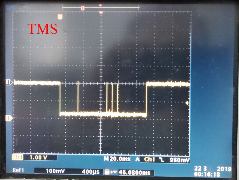

Hi, here's some facts that I can confirm:
1. The voltage values of VCCPGM, VCCIO_HPS, VCCIOREF_HPS, A10VCCPLL_HPS and A10VCCA_PLL are correct, range from 1.824V to 1.829V.
2. I design the JTAG circuit following the instructions in the handbook named "Configuration, Design Security, and Remote System Upgrades in Arria 10 Devices", as you can see in the following picture. All the resistors are soldered well.
3. The impedance values between JTAG pins(TDI, TDO, TCK and TMS) and GND range from 1.028KΩ to 1.180MΩ, and the impedance values between JTAG pins and VCCPGM range from 1KΩ to 1.180MΩ.
4. After power-up, TDI and TMS are high, TCK is low and the voltage of TDO is 0.612V. MSEL=000 and both nCONFIG and nSTATUS are high.
5. When I run "Auto detect" in Programmer, a error message occurs: "unable to scan device chain. Can't scan JTAG chain. Do you want to open the JTAG Chain Debugger to troubleshoot the JTAG chain?", as you can see in the following picture.
6. When I run "Test JTAG Chain", the Programmer reminds that TDI might be shorted to GND,and unknown devices detected, as you can see in the following picture.
7. When I run "Auto detect" in Programmer, the oscilloscope can capture waveforms of TDI, TCK, TDO and TMS, as you can see in the following pictures.auto detect TCK.jpg

JohnT_Intel
3,592 Views
1. Is the JTAG port of Arria 10 permanently damaged? How can I confirm that? It might happen. No way except replacing the device. 2. Currently I'm using Altera Usb Blaster, does usb blaster support Arria 10 SoC? Should I change to Altera Usb blaster II? Yes. Changing to blaster II will not help. 3. Do you have more suggestions for me to access the JTAG chain? From the schematic diagram, it shows only 2 device connected while in the JTAG chain debugger, it shows 3 device is connected. Could you confirm which connection is correct?
