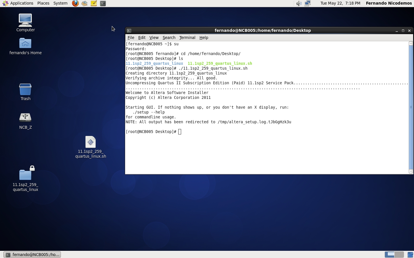

--- Quote Start --- I tried yum install gnome and it said No package gnome available. --- Quote End --- Sorry, I just guessed that the package name would be gnome. You already have a graphical desktop running, so you should just be able to run the install script, i.e., 1) In the graphical desktop, start a terminal 2) Login as root 3) Run the installer script via ./11.1_173_quartus_linux.sh or perhaps bash ./11.1_173_quartus_linux.sh 4) Follow the GUI Cheers, Dave
GUI does not start. Wicj mirror you downloaded your centos 6.2? I will try to download again and reinstall.
--- Quote Start --- GUI does not start. Wicj mirror you downloaded your centos 6.2? I will try to download again and reinstall. --- Quote End --- I assume you mean the Quartus GUI does not start. You already indicated that the Centos GUI was running fine. There should be no need to reinstall Centos, as you indicate its already running fine. Why don't you post a screen shot of what happens when you run the Quartus install script in the terminal? Perhaps it'll be clearer what you have done wrong. Cheers, Dave
Just one comment: I have a two DVD disk CentOs6.2 install. He does not ask for the second DVD. Maybe if i download the same .iso or file you have i will also have a know copy.
--- Quote Start --- GUI does not show up. --- Quote End --- So what did the log file have in it? Probably something about the fact that you need to install 11.1 first per my instructions above. Cheers, Dave
--- Quote Start --- Just one comment: I have a two DVD disk CentOs6.2 install. He does not ask for the second DVD. Maybe if i download the same .iso or file you have i will also have a know copy. --- Quote End --- It only uses the first .ISO. Your Centos install looks fine. Cheers, Dave
