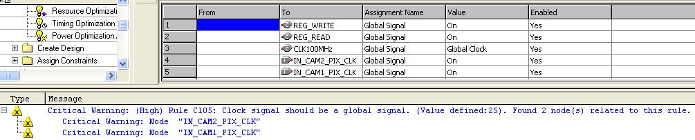

Hi again,
I'm filling the forum with all my questions.
But i'm learning from each one of it.
Now i have
the following problem. The compiler gives a critical
warning about 2 input pins. I have assigned them
as globals in the assignment editor but it still gives
the warning that i should make the pins global ...
In the image i took a snapshot from the warning
and the setting.

clock inputs must be assigned to dedicated clock pins. I think you have connected them to non-dedicated pins but then applied global setting.
It is not the recommended design method.
