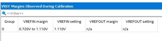

I instantiate a EMIF IP core with DDR4 protocol in my design, modify memory timing parameters and board skew values.
The DDR4 speed bin is 2400 and CL=16.
After programming the device in EMIF debug toolkit, I get the following calibration report, and emif_clk_user is correct, measured 267MHz≈1066.667MHz/4, but the local_cal_sucess is low.
The following pictures and txt files are resluts of EMIF debug toolkit. I will be appreciated if anyone can give me some suggestions.

The calibration failed at "write per-bit deskew" stage, any suggestions?
Thanks.
BoonT_Intel
3,569 Views
  • Check the DQ/DQS line length matching. Confirm is the board layout meeting the guideline.
  • Try to reduce the interface frequency and retry. From the screenshot, looks like you are using 1066MhZ? Maybe reduce to 533Mhz.
  • change the data line output and input impedance setting. - on FPGA IO tab.
SYiwe
3,569 Views
thanks.
In my current design, maximum skew within DQ/DM/DQS is 7.3ps, but both "maximum board skew within address/command bus" and "average delay difference between address/command and CK" exceed ±20 ps, I think that violate the guidelines and results in calibration error, although no errors in "Report DDR".
Is there any way to solve this problem except hardware update?
thanks, regards.

Basically we need to follow the board design guideline to get the calibration pass.
for now, I think you can try to reduce the frequency of the interface.

Basically there is no other way to fix the hardware issue. but I can suggest you give a try on reducing the frequency to half of current interface frequency and see if the calibration pass.
