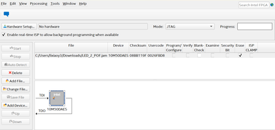

What do you exactly mean to "erase MAX 10"? Do you mean erase the image in CFM (Configuration Flash Memory)?
If you are using Intel Programmer, just put any JAM file matching your device, and select "erase" operation, then "start" operation.
If you are using Jam player or other command lines, normally there's "Erase" command to perform "Erase" to MAX 10.
(Intel Programmer)
