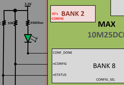

I have a requirement to connect LED to CONF_DONE pin to indicate the status of configuration. Is it fine to connect a LED directly to conf_Done pin with current limiting resistor around 300 ohm, or do we need to adhere to the 10Kohm resistors as mentioned in the datasheet?
NurAiman_M_Intel
951 Views
You may try to use the lower value however we recommend to follow the datasheet as it has been tested by Intel.
