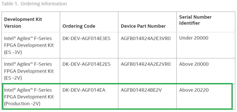

I am currently working on Agilex FPGA (Agilex: AGFB014R24B2E2V). I am trying to program it for the generated JESD204B example design (preset 888). While doing same I am getting the error. I have referred this solution (https://community.intel.com/t5/Intel-Quartus-Prime-Software/Error-when-programming-Agilex/td-p/1350037) but nothing seems to work. Kindly help.
Please let me know if more info required from my side.
Note - I am able to generate .sof file successfully.  Quartus version 22.2.
My VID settings
set_global_assignment -name USE_PWRMGT_SCL SDM_IO0
set_global_assignment -name USE_PWRMGT_SDA SDM_IO12
set_global_assignment -name VID_OPERATION_MODE "PMBUS MASTER"
set_global_assignment -name PWRMGT_BUS_SPEED_MODE "400 KHZ"
set_global_assignment -name PWRMGT_SLAVE_DEVICE_TYPE OTHER

Hi Shubhangi,
Good day.
After further checking it seems like it might be some issue with the VID settings.
Based on your Agilex part number, I believe you are using the Agilex F-Series FPGA devkit Production-2V.
For the VID setting, you are required to input below script/code to avoid Quartus from generating an error due to incomplete SmartVID settings.
Intel® Agilex™ F-Series FPGA Devkit User GuideIntel® Agilex™ F-Series FPGA Devkit User Guide
You may change the scripts listed below in you project QSF file.
Please ensure that there are no other similar settings with different values.
6.1. Add SmartVID settings in the QSF file6.1. Add SmartVID settings in the QSF file
For more information you may refer to below link:
Intel® Agilex™ F-Series FPGA Development Kit User Guide - 6.1. Add SmartVID settings in the QSF file
Please try this step and let me know if error still happen.
Thank you.

I am sorry for replying late.
Yes this new settings works fine.
Thank you so much for the help.
