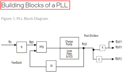

Hi Teh,
I found the following PLL Block Diagram for the Intel FPGAs:
It kind of implies that there are only 2 clock outputs for the PLL.  My design uses 4 phase shifted 200 MHz clock outputs (0, 90, 180, 270 degrees phase shift).  The input clock is 100 MHz.  Can the PLL hard core provide this?   You mention the PLL Soft Core IP can provide this, but will the PLL Soft Core IP use a lot of fabric resources?

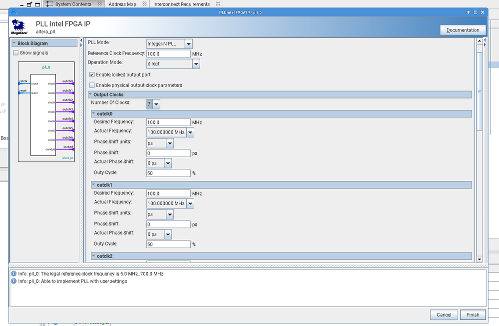

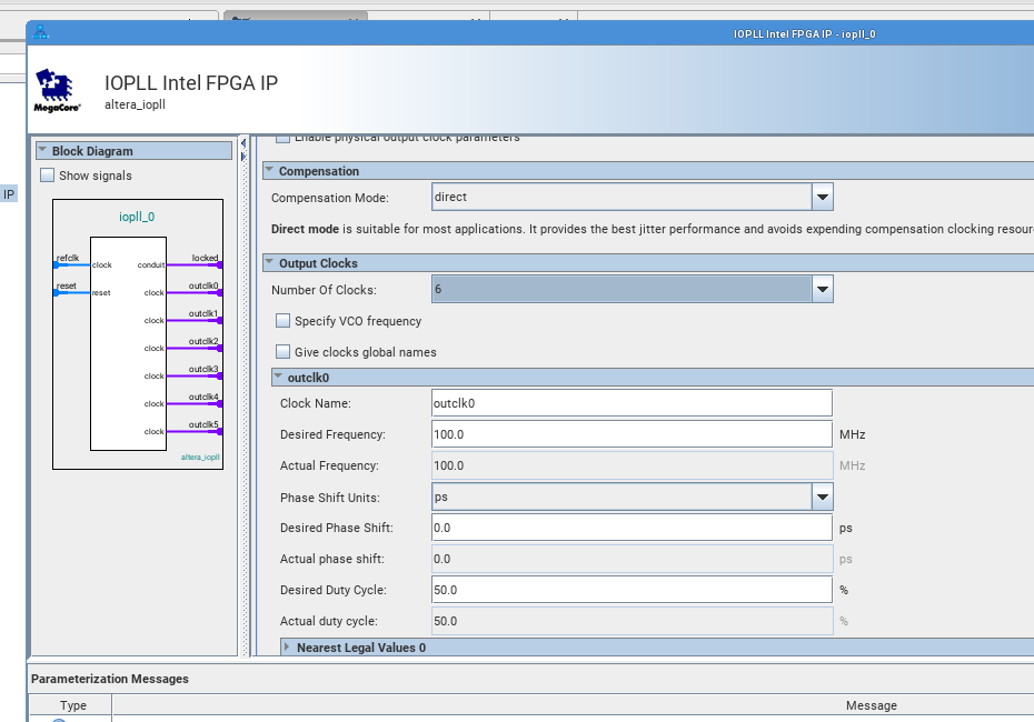

Hi Vyoung
Yes. In the the IP configuration the you could select the numbers of clocks output you would like and the phase difference in between the clocks.
Please refer to the diagram below:
As for the fabric resource I do not have that information but I assume that it would not take up a lot of resource as it is a common IP that is being used.
