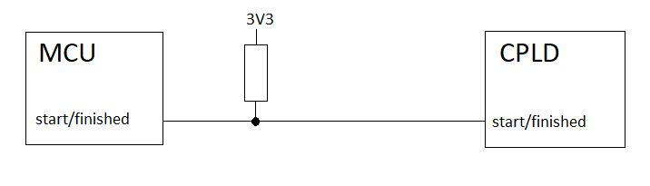

Let me explain the start signal (for now I renamed it start/finished as it better describes it purpose).
Here is schematic:cpld.png
Normally, no chip is pulling the line low - both chips sets the pin with start/finished line to high impedance input. When MCU wants CPLD to start its job it configures start/finished pin to output and writes 0 to it (pulls it low) for at least one clock period so the CPLD is able to catch that. CPLD detects this "start condition" and pulls the line low also to tell MCU that it is working. When the job is done, it again configures start/finished pin to high impedance input which means rising edge will happen on the line (as no chip is pulling it low) which can be detected by MCU...
If what I have written can't be implemented in CPLD then that is good news for me as it means the problem is solved. I can move start <= '0'; to the next state (that happens just one clock period after, that is perfectly OK) and extend MCU's start pulse to 2 clock periods (so there is no rising edge meaning false job done). But of course, I would like to be sure that this is the problem.

Hi, The Max V IO pins support open drain but it will depending on you implement it. You should be able to look into your Quartus fitter result to see if the pin is configured as open drained. Have you tried to performed simulation to see if you are implementing it correct?
MDuse
2,189 Views
This is pinout for start signal (output of Fitter):
Pin Name/Usage : Location : Dir. : I/O Standard : Voltage : I/O Bank : User Assignment
start: 44 : bidir : 3.3-V LVTTL : : 2 : Y
I simulated it and was not able to reproduce the issue. I tried to move falling edge of start signal relative to clk_out clock to several positions when simulating, but the issue never happened when simulating.

I didn't observed that the open drain is enabled. Usually you need to design it where you can either follow the guide in https://www.intel.com/content/www/us/en/programmable/support/support-resources/knowledge-base/solutions/rd06252007_878.html or use the IP in Quartus (https://www.intel.com/content/dam/www/programmable/us/en/pdfs/literature/ug/ug_altiobuf.pdf)
MDuse
2,189 Views
But it is bidir which should be good for me as long as CPLD can set bidir pin to 0 and to high impedance state and is able to read its state.
So, can you confirm, that this implementation that is present in my code:
if start = '0' then start <= '0'; end if;
is bad idea and I should do it in some official way?
JohnT_Intel
2,189 Views
Hi, Then I would recommend you to use OE to control whether to drive '0" or high Z.
MDuse
2,189 Views
Yes, I will do it this way and perform some testing to see if that was the cause of my problem.

I modified my VHDL and now testing. It seems it works, RTL looks simpler with new version of code but we have to monitor it for longer time. The issue happened months after we were using original code and only with two devices.
