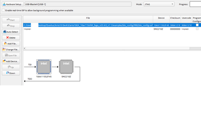

Can I program this kit's FPGA using a .sof file or do I need to first generate a .flash file? Please include instructions if a .sof file is sufficient. Thanks.

From my experience, you should auto detect, it should be able to detect both Max and Arria 10. This is some how necessary for the Programmer to know the chain of FPGAs. Then you should select the sof file for that particular FPGA and program it.
