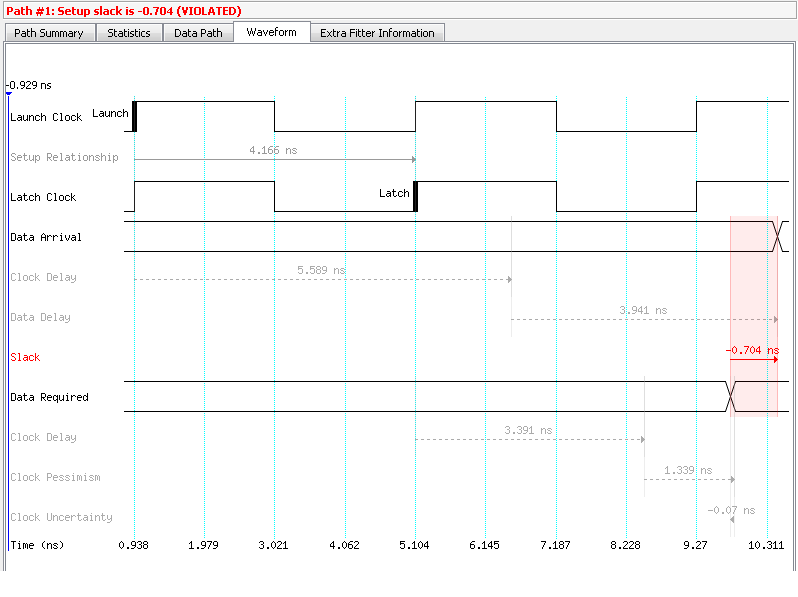

I am using 5CGTFD5C5F27C7 in my project to receive synchronous data from a 12-bit ADC. the data rate is 480Mbps, for i need to use dynamic io delay to compensate for the fixed delay caused by ADC itself, i could not use ALTLVDS_RX core. so I instantiated DDIO_IN ip core to latch data from ADC with 240MHz clock. For CycloneV FPGA, DDIO_IN is directly implemented in its IOE unit and it is great. After Fittting, TQ reported timing violation. I checked the data arrival path and found that there was a large IC delay(3.452ns) caused by signal routing from IOE to LAB. I made serial-to-parralel conversion in LAB unit. In order to decrease such a large IC delay, i use logiclock feature to constrain the LAB to be adjacent to the relevant IOE. In fact, the LAB and the relevant IOE are next to each other after constraintion. However, after fitting, TQ still reported timing violation and the large IC delay was still there(around 3.4ns)! This is interesting, for two physically adjacent unit would have such a large IC delay, i do not know the way Quartus routing signal, but it looks unreasonable to me. i think 3.4ns is a large delay in nowadays design, especailly in a 28-nm FPGA. I basically think that Quartus should prevent that large IC delay, even after TQ has reported that violation(i think it is what timing-driven synthesis should do). Please help, how can i decrease such a large IC delay in CycloneV? Even put them physically together won't help? I am puzzled, or did i miss something obvious? Best Wishes, ingdxdyLink Copied

your waveform shows launch clock delay of 5.589 ns while latch clock delay is 3.391 + 1.339 (ns).
This may give a clue to the negative setup slack. Why launch clock is so delayed?- Mark as New
--- Quote Start --- your waveform shows launch clock delay of 5.589 ns while latch clock delay is 3.391 + 1.339 (ns). This may give a clue to the negative setup slack. Why launch clock is so delayed? --- Quote End --- Yes, clock skew is around 0.86ns, this may be a source of the negative setup slack beside large data IC delay. I do not know why there is such a large skew between launch and latch clock, because it is out of my control. Both launch and latch clock come from the same 240MHz clock which is generated by a PLL. I checked the fitter result, this 240MHz clock is routed through global clock network, so there should not be such a large skew. The launch clock is fed into IOE to clock the two ddio input registers, while the latch clock is fed into LAB register, does that matter? does routing to IOE be a difficult task? i have no idea. Best Wishes, ingdxdy
--- Quote Start --- Yes, clock skew is around 0.86ns, this may be a source of the negative setup slack beside large data IC delay. I do not know why there is such a large skew between launch and latch clock, because it is out of my control. Both launch and latch clock come from the same 240MHz clock which is generated by a PLL. I checked the fitter result, this 240MHz clock is routed through global clock network, so there should not be such a large skew. The launch clock is fed into IOE to clock the two ddio input registers, while the latch clock is fed into LAB register, does that matter? does routing to IOE be a difficult task? i have no idea. Best Wishes, ingdxdy --- Quote End --- Try remove PLL from design to reduce complexity for now and only use it if then timing fails. Also you need to identify which path gave above failed waveforms; is it io path between adc and DDIO or internal path after it and have you written sdc with set_input_delay constraints?
--- Quote Start --- Try remove PLL from design to reduce complexity for now and only use it if then timing fails. Also you need to identify which path gave above failed waveforms; is it io path between adc and DDIO or internal path after it and have you written sdc with set_input_delay constraints? --- Quote End --- I need PLL to lock input synchronous clock from ADC, also with 90 degree phase shift to latch input data. So Removing PLL is unpractical. path between DDIO and internal fabric is failed in timing analysis. I used set_input_delay to constrain the sync input, however, it had no influence on my problem. as i just said, it is the path between DDIO and internal fabric that has negative setup slack, not the path between adc and DDIO. Best Wishes, ingdxdy
--- Quote Start --- I need PLL to lock input synchronous clock from ADC, also with 90 degree phase shift to latch input data. So Removing PLL is unpractical. path between DDIO and internal fabric is failed in timing analysis. I used set_input_delay to constrain the sync input, however, it had no influence on my problem. as i just said, it is the path between DDIO and internal fabric that has negative setup slack, not the path between adc and DDIO. Best Wishes, ingdxdy --- Quote End --- Well you don't actually need PLL or 90 degree phase shift but it can help timing failure. Anyway there is no clear picture of your io constraints. You need sdc commands for all adc inputs and based on DDR examples cutting off unrelated edges. I have feeling that your sdc commands for inputs are misleading the reporting, just a guess. I am also not sure why clock pessimism is added to latch clock delay, is clock pessimism removal enabled, though its removal will make slack worse based on your waveforms.
--- Quote Start --- Well you don't actually need PLL or 90 degree phase shift but it can help timing failure. Anyway there is no clear picture of your io constraints. You need sdc commands for all adc inputs and based on DDR examples cutting off unrelated edges. I have feeling that your sdc commands for inputs are misleading the reporting, just a guess. I am also not sure why clock pessimism is added to latch clock delay, is clock pessimism removal enabled, though its removal will make slack worse based on your waveforms. --- Quote End --- yes, set_input_delay and set_false_path are used for adc inputs and cutting off edges. Maybe my sync constraint in the sdc file misleads the Quartus to make a long delay for the DDIO register clock, and this results in the negative setup slack between DDIO register and internal register, i will look into the sdc file carefully. And you said "is clock pessimism removal enabled", what does this mean? can clock pessimism removal be disabled?from where in Quartus? Thanks a lot. ingdxdy
--- Quote Start --- And you said "is clock pessimism removal enabled", what does this mean? can clock pessimism removal be disabled?from where in Quartus? Thanks a lot. ingdxdy --- Quote End --- clock pessimism removal should be enabled by default, go to quartus/settings/timing analysis settings and see clock pessimism removal box is checked. It means for common clock path (that initial part shared between launch and latch clocks) the max/min difference effect should be ignored as physically you should either have max or min but not both on same physical line at anytime. If allowed it adds false unrealistic figure to setup slack and subtracts from hold slack. Your clock pessimism of 1.3 ns is also too high!
