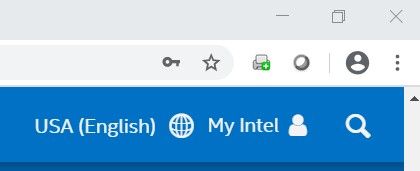

https://www.intel.com/content/www/us/en/programmable/support/support-resources/knowledge-base/component/2019/global-setting-is-not-supported-the-instance-as-listed-below-in-.html?wapkw=329006
You will not see this within the forum. You have to do a search for "329006" here:
Somebody has said that these assignments are obsolete. Why does Intel still keep them and cause confusion?
