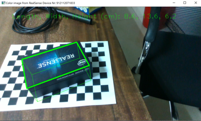

I work for logistic company, we have a project measure dimensions small objects like USB, lipsticks, ... please see my attachment.
Follow this topic: https://github.com/IntelRealSense/librealsense/tree/master/wrappers/python/examples/box_dimensioner_multicam I have clone and run successfully, but we have a problem, with 2 cameras model D435i I have detected dimensions with not high accuracy. The dimensions which receives from 2 D435i are Length x Width x Height 1.7 x 7.3 x 2.1 (cm) , but real dimension are 1.5 x 7 x 1.5.
the distance from cameras to chessboard is 40 cm.
Kindly give me a advise to improve the result because our boss need more accuracy.

Yes, I have changed it to 13 x 9 and square_size = 0.02 (cm)
I have tested with bigger like box real sense, the result is 10x15x6.6 but real is 9 x 14 x 5.

I note in your script that you are using 1280x720 resolution.  The optimal resolution for best depth accuracy with the D435 / D435i models is 848x480

I have a re-config resolution 848x480, but it is still not more accuracy, you can check this image below:
so if it can not have 100% accuracy, kindly provide me how percent accuracy we can have? so i will report for my manager.

It is not possible to achieve 100% accuracy, as the error factor (RMS Error) starts at around 0 at the camera lens and increases linearly over distance.  It is expected that accuracy will be less than 1% of the distance of the observed object from the camera.  For example, at 1 meter range this may convert to an expected accuracy of 2.5mm to 5mm.  There are various factors, including environment and lighting, that can affect accuracy though.
The correct method is to start the program without any objects on the chessboard and allow the cameras to calibrate, and then only place the object on the chessboard when the program asks you to.  Are you using the program this way, please?

Sure, when I start the program without any object on the chessboard and after all calibrations finish the program shows the command line: place the box in the FOV of the view... I use it right, please?
And one more question, how about small objects such as lipsticks, USB, ...? with normal set up I saw the program can not detect them, so you have any idea for measurement dimensions them?

The procedure that you describe is correct.
For the next test, please try aligning the box so that its edges line up with the squares instead of having the box point diagonally across the chessboard.
The cameras can measure objects that are the size of a USB stick or lipstick, but the box_dimensioner_multicam program was not designed for objects that small, but instead for the measuring of boxes.
