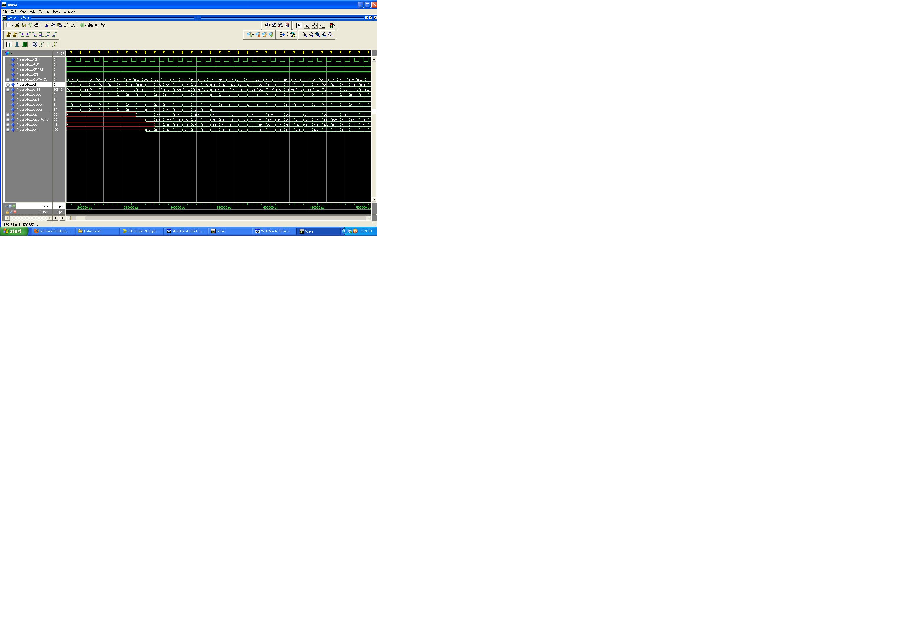

I have write vhdl code for divide by two operation. Below is the short code:
SRL16_a:process(CLK) begin -- SRL16 if CLK'event and CLK='1' then if en='1' and (cycle=0 or cycle=2 or cycle=4 or cycle=6) then sr16<=di & sr16(0 to 14); -- shift SRL16 end if; end if; end process; a1<= sr16(ad1); -- output from SRL16 SM_B:process(clk,rst) begin if RST = '1' then di <= (others => '0'); bp <= (others => '0'); bm <= (others => '0'); elsif CLK = '1' and CLK'event then if en = '1' then if d_signed =0 then di<=unsigned(DATA_IN) - unsigned( a1_2); else di<= DATA_IN; end if; add_temp<=SXT(di,9)+a1; bp<='0'& add_temp(8 downto 1); bm<=SXT(di,9)-a1; end if; end if; end process;
I try to add to numbers (di & a1), and then divide the sum by 2. When I simulate the testbench code in ModelSim, the values of add_temp and bm is correct. But, the values of bp is wrong (not as manual calculation). I attach the figure. Anyone please help me. Do I make anything wrong?Thank in advance

Your simulation shows that a1 dosent become valid for 08 clock cycles .
If you can send me the complete VHDL files plus test bench i can take out some bugs .

According to my manual calculation, the bp values are as expectable. You are doing a logical shift right, probably you want an arithmetical shift with sign extension?

Is it the bp values are exceptable? In my manual calculation (I take one example), add_temp:108+(-25)=83. Then, bp: 83/2=41.5. From the waveform, it seems correct. But, the next values is it should be, add_temp: -25+(-25)=-50. Then, bp: -50/2=-25. And so on. Please correct me. Thank in advance

-25 would be 0x1e7. Due to logic shift right, you get 0x0e7 instead, or 231.
For arithmetic shift, write
bp <= add_temp(8) & add_temp(8 downto 1);
