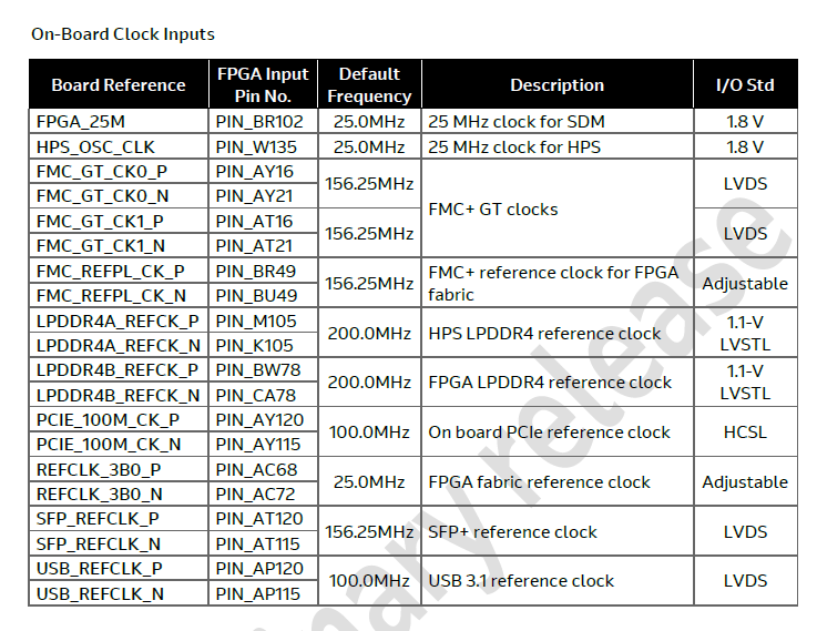

I'm using GTS AXI Streaming intel FPGA IP for PCI Express to implement PCIe on Agilex 5 FPGA (A5ED065BB32AE4 ,Quartus Prime 25.1) . I connect Pin p0_pin_perst_n_i to a 3.3v pll up resistance on the board while pin p0_pin_perst_n_1_i is left floating . When testing on the board , p0_pin_perst_n remains asserted and the p0_reset_status_n remains low . It seems like the IP cannot jump out off reset . I wonder what may cause this situation and how can i solve the problem .

1. The board i use is AXE5-Eagle made by Arrow , not a Intel dev kit .
2. I confirm the pin assignments are correct . I'll post some related parts of schematic diagram in the following pictures .

I use the Design Example generated from Quartus only with these modifications .
1. I change the frequency of IOPLL refclk from 100Mhz to 25Mhz .
2. I add STP and pin assignments for the Eagle board .
I followed your guide but i have never observed p0_pin_perst_n toggling from low to high still .
I checked the pin assignments for refclk and PERST# and found nothing wrong with them . I will post some parts of user guide of the Eagle board in the following pictures so you can help me check .

Since you are using Agilex™ 5 ES E-Series devices, please make sure the pin location assignment for p0_pin_perst_n_i and p0_pin_perst_n_1_i are assigned correctly. For the other reset pin that is not used as PERST#, it must be left floating at board level. Please refer to Section 4.2 of the user guide: https://www.intel.com/content/www/us/en/docs/programmable/813754/25-1/resets-18963.html
