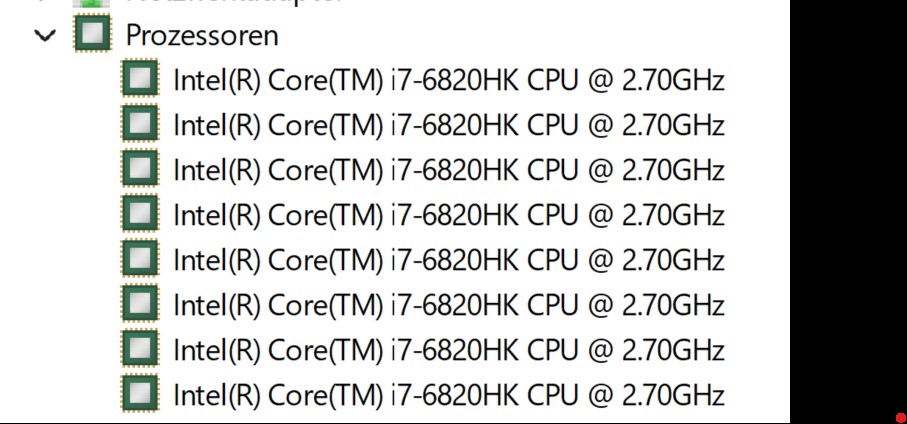

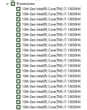

1) Is my understanding correct that you want to transfer current the Windows 11 installation configured in RST RAID 0 array from Alienware 17R3 to another laptop (Dell G15 5530)? So, one is an older laptop (Alienware 17R3) and migrating to a newer one (Dell G15 5530)? Is that correct?
2) What processors does each laptop have?
Ernesto C.
1) yes
2) see jpg

Hi @Alienrage,
Thank you for your patience. After further checking, OS migration from 6th gen platform (i7-6820HK) to 13th gen platform (i7-13650HK) is not guaranteed to work due to having different BIOS settings/configuration and possible vendor customizations on each respective motherboard involved.
With this in mind, it would be best to setup Windows OS from scratch on the newer platform.
I'll proceed to close this case now. Feel free to create a new thread if you have any concerns or questions.
Ernesto C.
