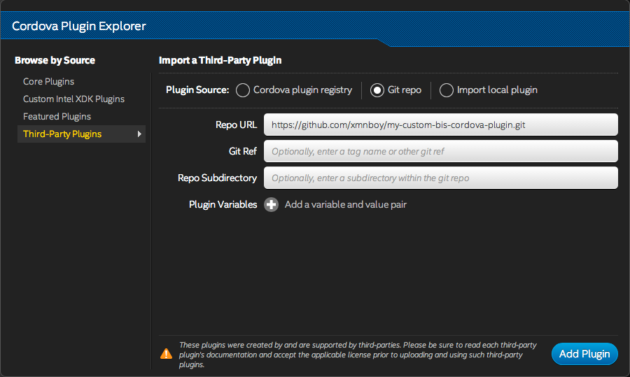

Normally, I would tell you to put your plugin.xml file inside a folder named "my-custom-bis-plugin" (see the id in plugin.xml above). And then "import" that plugin using the plugin management tool on the Projects tab as a "local plugin." However, there is something wrong with the local import tool, so I have created a version of the plugin in my github account and you can try and add it from there.
I have no way to test this (because I don't have an app that requires a BIS key), so you'll have to give it a try. See this image for how to add it as a git repo plugin. The XDK will prompt you for a BIS_KEY, which should then get automatically added when the plugin is built.

Hi Paul, thank you very much for pulling this together. I've run through the steps as above and entered the appropriate key, and I can see the data in the intel.config.ios.xml file. The custom plugin is visible in my build. I've done 2 builds with this but unfortunately the App Store still says I'm missing encryption exemption and keeps prompting me to include the key/string in the plist in my next build. I'll do a screenshot next time I do an update (probably tomorrow) so you can see the exact message.
