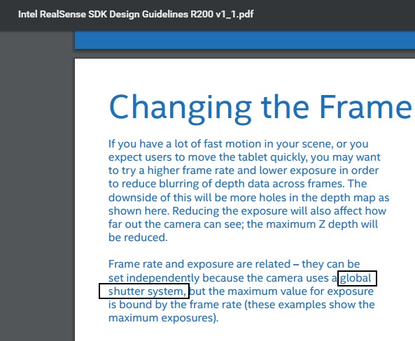

I didn't have any luck finding the F200's shutter type either.
Regarding the R200 camera, an Intel PDF says that the R200 uses a global shutter. That doesn't necessarily mean that the F200 does also, since the two cameras don't share the same hardware design.

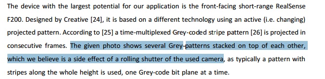

Edit: a couple of sources speculated that the F200 used a rolling shutter, a conclusion that was based on artifacts on images generated by the F200. They had nothing to back up their conclusion other than guesswork based on such images though. Here's an example commentary:
Well, these guys are basing their guess on the images I provided here:
https://software.intel.com/en-us/forums/realsense/topic/537872
Now, those images were not taken by the F200. I used another high speed infrared camera. You can actually see the F200 in the frame!. So, any comment on image acquisition of those images would not apply to the F200 at all.

Thanks for the info, Samontab. I was surprised that the information PDF for the F200 didn't quote the shutter type in the same way that the R200 PDF did.
