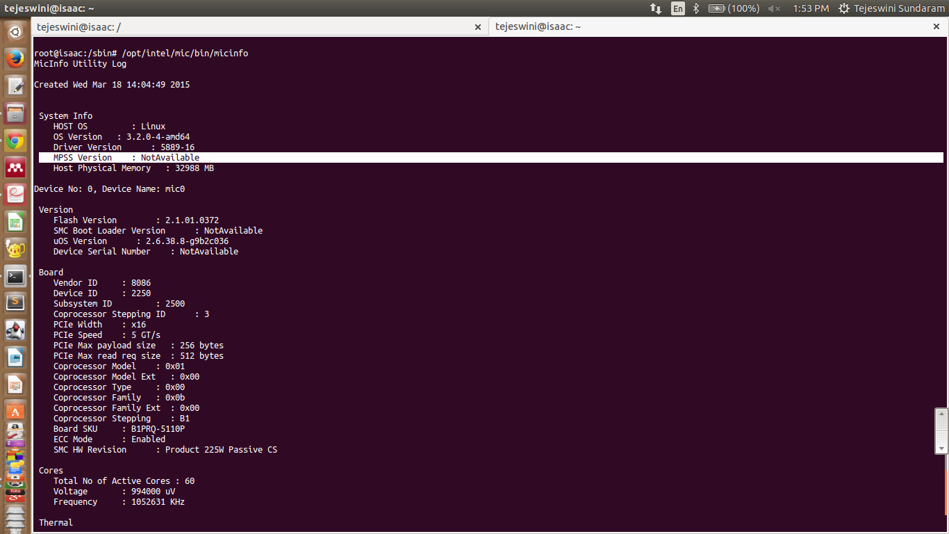

Hey i would like to view the version of MPSS installed in my machine. I ran the following command
# /opt/intel/mic/bin/micinfo
However, My output says MPSS Version: Not Available . I am able to start and stop the mpss stack by the following commands, and hence i am sure MPSS is installed.
$ sudo service mpss start/stop
I have attached the screenshot of my output for /opt/mic/bin/micinfo for your reference. Kindly suggest on how i can find the version.

From your output, it appears you are running a Debian kernel - possibly Ubuntu? And the flash version on the card has not been updated. Also, the format of the output appears to be corrupted - the mic driver version is not a valid version number and there is no SMC Firmware Version field. These symptoms seem familiar. To help me track this down, could you tell me
  • did you just install this release of the MPSS?
  • has the micinfo command given you the correct output at any point in the past?
  • what version of the MPSS do you have installed?
  • what operating system and version are you running on the host system?
  • given that you appear to be running a Debian system, did you use a program like alien or did you install rpm in order to install the MPSS rpm files?
  • did you rebuild the kernel module from mpss<version>/src/mpss-modules-<version>.src.rpm?

Ah, there is nothing quite like taking over a system that someone else has been administering, is there? Well, lets see where to go from here.
The easiest way to find the MPSS version might be 'micinfo -version'. This will give you the version number of micinfo, which should match the MPSS version. That gives you the answer to your original question.
In looked back over my notes, I remembered that, on systems where the Debian installer is used, micinfo will not give the MPSS version. This implies that something like 'alien' was probably used to convert the rpm files in the MPSS release into Debian style files, then the Debian installer was used to actually install the files. Either that or the rpm utility was installed on the host prior to installing the MPSS and has since been removed. Either way, before you upgrade the MPSS you will need to find out for sure - the old version of the MPSS must be uninstalled before the new version is installed.
