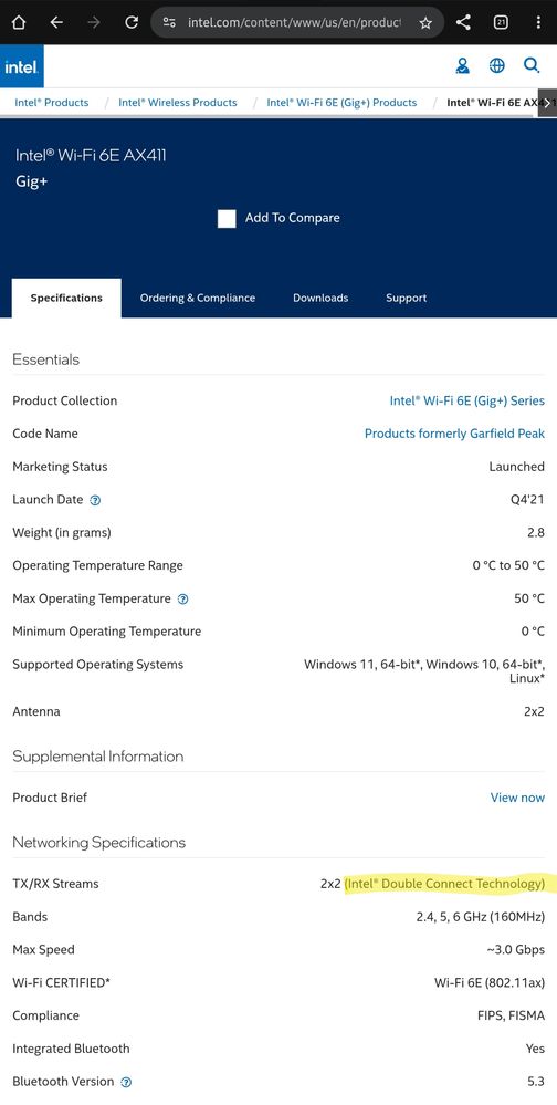

Here's all I really want to know:
Intel specify the AX411 supports Double Connect.
In a system that meets all necessary requirements, what is Intel's intended way for a customer to enable Double Connect?
Does Intel have a utility program that customers can use?
Or does Intel expect the system manufacturer to create their own utility program, something akin to Lenovo Vantage, and Intel only provide access to Double Connect on the AX411 in the form of an API?

staticV3
80 Views
@JeanetteC_Intel wrote:
Regarding Double Connect on the AX411, I need to clarify that this feature is only available on Intel Killer wireless adapters, not on standard Intel Wi-Fi adapters like the AX411.
And yet, Intel write:
Source: https://www.intel.com/content/www/us/en/products/sku/217242/intel-wifi-6e-ax411-gig/specifications.html
