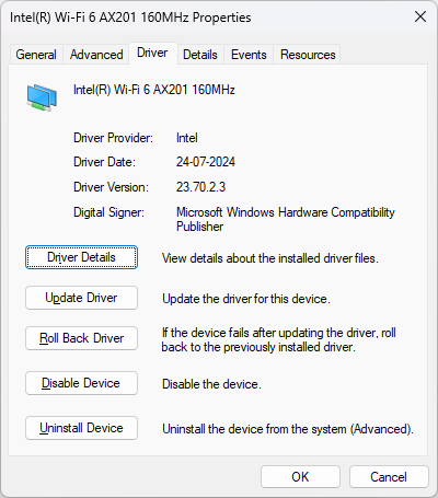

Kamlesh
3,825 Views
I am facing exactly the same issue. @Lynxes did you manage to get this fixed?  Sharing my adapter details as screenshot here.

Hey just wanted to chime in, I had this issue for the past month and just fixed it. Here is what fixed it:
First i installed the latest intel driver non-related to the motherboard straight from intel: https://www.intel.com/content/www/us/en/download/19351/intel-wireless-wi-fi-drivers-for-windows-10-and-windows-11.html
Then rebooted. Noticed it didn't fix it...
So then I tried to find the specific motherboard driver from asus. In my case this is the page for my motherboards drivers: https://www.asus.com/us/motherboards-components/motherboards/tuf-gaming/z590-wifi-gundam-edition/helpdesk_download?model2Name=Z590-WIFI-GUNDAM-EDITION
There is no wifi driver for mine so I downloaded the lan driver and extracted it to a folder.
Then I did these steps:
Device Manager -> Network Adapters -> Right click on 'Intel(R) Wi-Fi 6 AX201 160MHz' -> Update Driver -> Browser my computer for drivers -> Let me pick from a list of available drivers on my computer -> Have disk -> Browse -> Select the extracted driver folder -> click yes on the warning....
Plot twist, then I bluescreened and It sent me into safe mode
however I then reinstalled the first driver from intel's website again and it started working fine.
So it seems as though my wifi driver just needed a complete wipe and reinstall in order to work?
Maybe skipping the middle step aka the whole bluescreen and just doing this would solve it too:
1. Download latest intel wifi driver from intel website
2. Open Device manager and uninstall the device for the wifi card. (Hopefully this completely resets it and wipes the info in order to fix it as needed!)
3. Install the intel wifi driver
