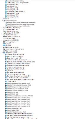

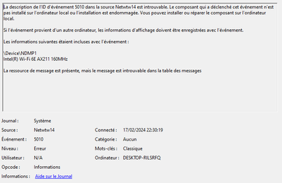

Since yesterday, my wifi card Intel AX211 keep internet dropping and slowing.
I tried clean installation and downland latest driver 23.20.0 but i have the same problem and the rollback 22.240.0 have exactly the same problem too
My final soluce for AX211 is 22.80.1.1 is working fine.
This ID 5010 keep internet drop.
This original intel keep and slowing internet connection with ID 5010 (Netwtw14)
My patch without or almost connection dropping (Netwtw12)
This stable driver with none error (Netwtw10)
My last question, uninstall all versions drivers before installing intel for admnistrator ?

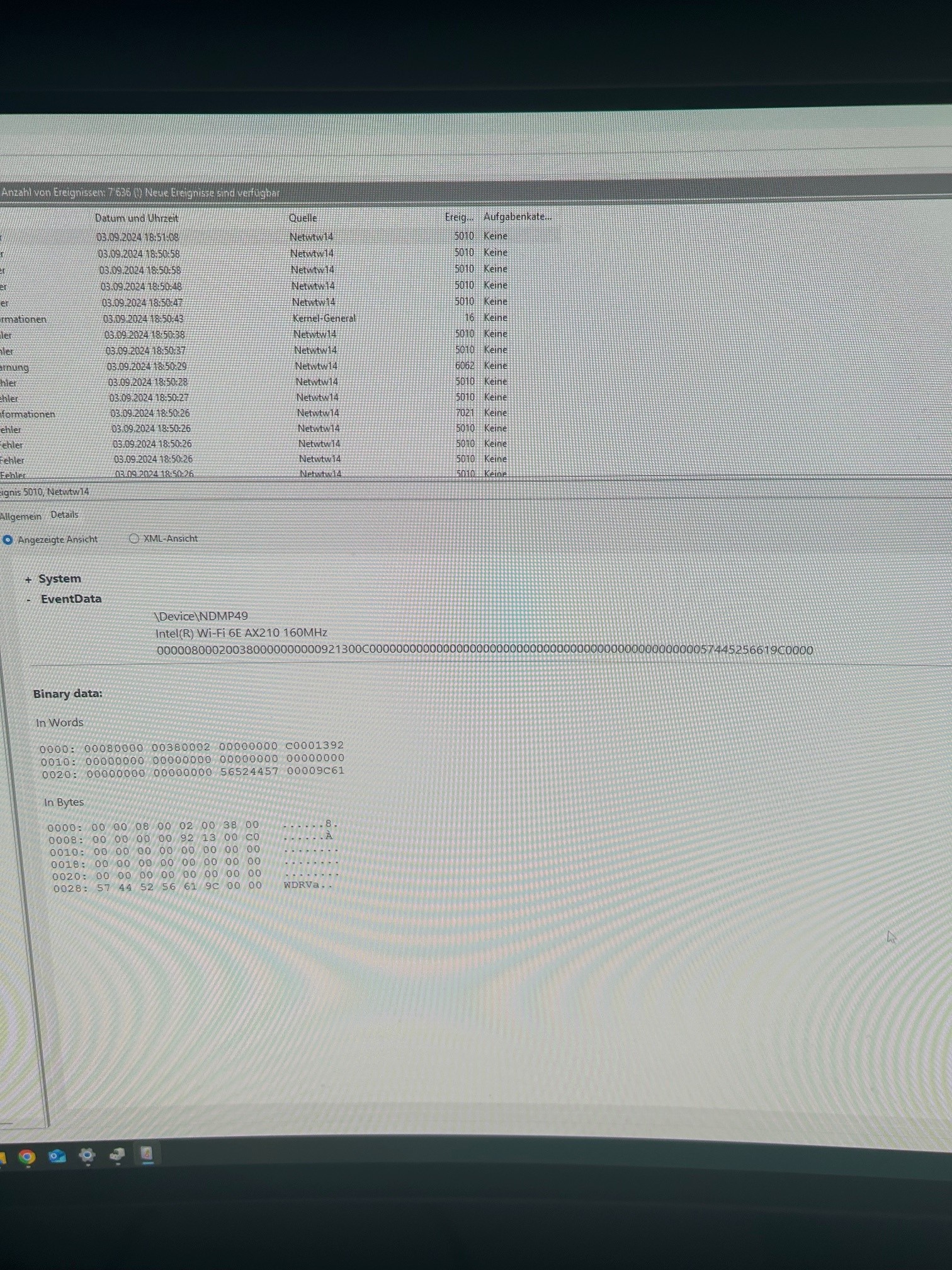

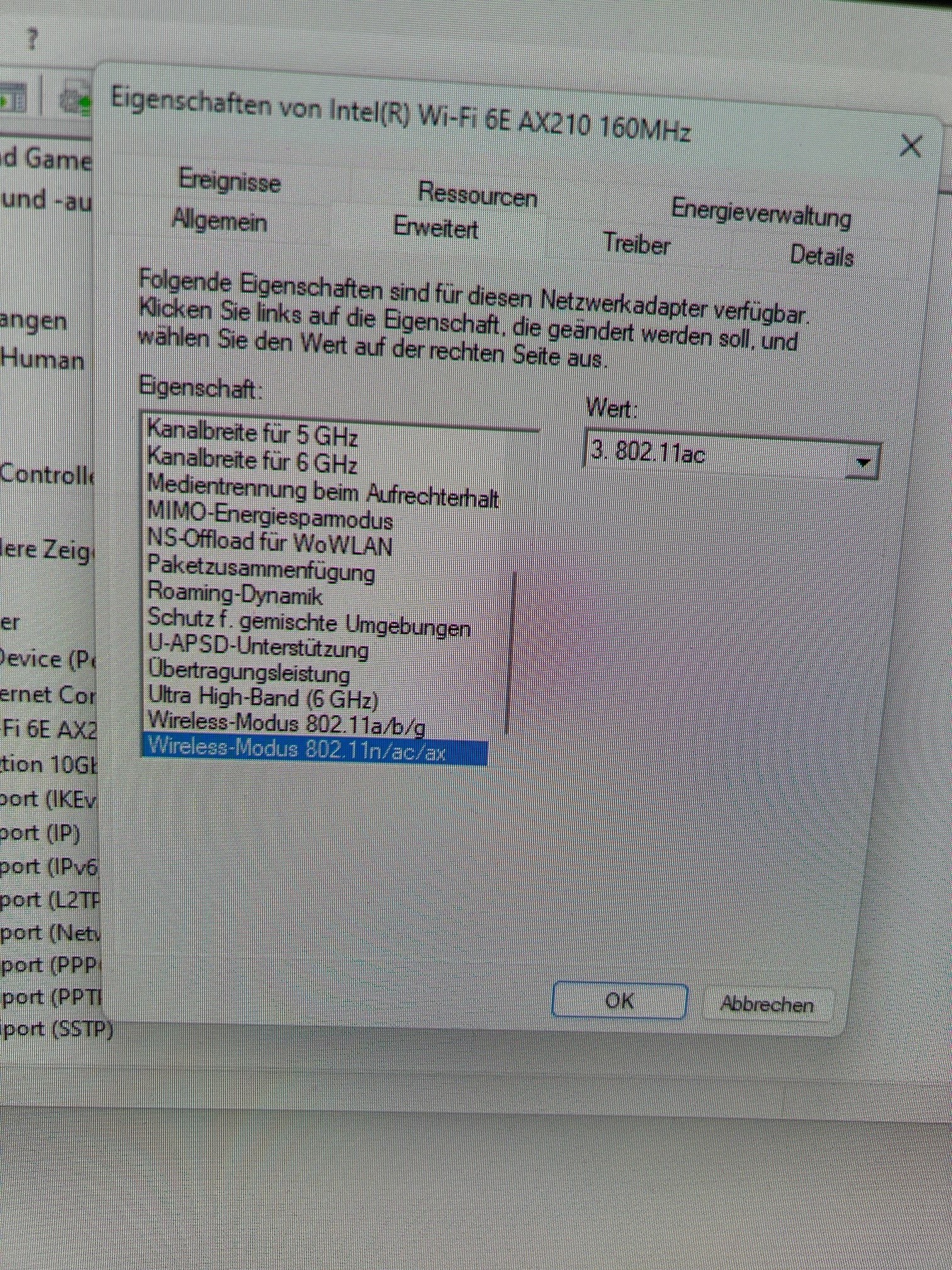

Hello everyone I get the following error every few seconds in my event viewer on my PC with Windows 11: Inter® Wi-Fi 6E AX210 160MHz: The network adapter returned an invalid value to the driver When wireless mode is set to 802.11ac in Intel driver in Windows 11, I don't get any error. I use the latest Intel driver version: 23.70.2. I used Intel's recommended settings: Recommended Settings for 802.11ax Connections (intel.de) Windows 11 completely reinstalled.

@Babylon87
Intel® Wi-Fi 6E AX211 160MHz, currently I am using Realtek Ethernet lan,  but I settled in advanced
802.11a/b/g Wireless mode to Dual band 802.11a/b/g
802.11n/ac/ax Wireless mode to 802.11ax
No errors
