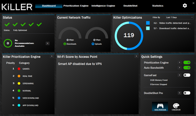

Instead, the issue is related to the "Killer Intelligence Center" application. This app is mistakenly identifying something similar to a VPN, which is causing the SmartAP function to be turned off. This problem began when I updated the program to version "KillerPerformanceSuite_34.23.7168".

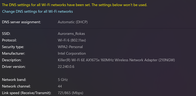

1. I installed the adapter, but it worked without any problems or errors until the software update of the "Intel Killer Center".
2. It is a laptop
3. Asus Zephyrus G14
4. Windows 11 Pro
5. Bios version 318 of 4/6/2023
6. The "Smart AP" function is disabled because "Intel Killer Center" detects as if there is a VPN on the computer when there is not.

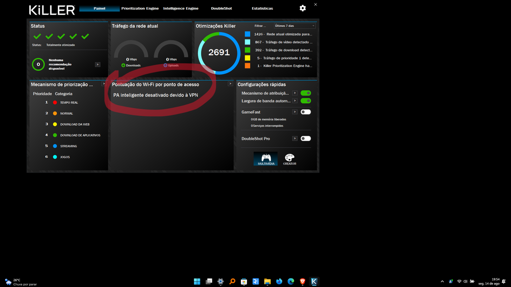

Exactly !! the same issueCaptura de Tela (5).pngCaptura de Tela (6).png, after updating the Intel® Killer ™ for version 34.23.7168 the killer
Control Center deactivated Smart AP by "thinking" that there is a VPN installed even having none.

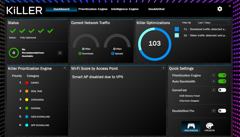

The error persists in the latest version of the software "Killer Intelligence Center" specifically in version "34.23.7168 (Latest)", but in version "34.23.5134" this error is not present.  
Killer Intelligence Center / 34.23.7168 (Latest)
Killer Intelligence Center / 34.23.5134
