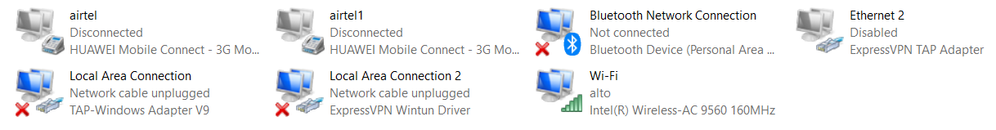

My 6 month old Dell Laptop ( Inspiron 15 7591) used to work just fine with my Home Wifi (screenshot below, showing the "alto" SSID), typically giving speeds upto 100 mbps (150 mbps is the advertised broadband connection speed).
Suddenly for the past few days I have noticed it doesn't exceed 20 mbps (mostly about 5 mbps). Both upload and download speeds are low. Stuff I've checked so far (I've posted additional debug info at bottom of post):

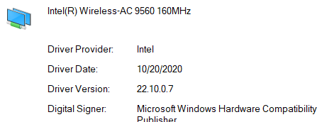

- Installed the latest driver from the Intel site (Version 22.10.0.7) for my Wifi adapter (Intel(R) Wireless-AC 9560 160MHz)
- Checked driver updates on dell. Says I have the latest version: " No driver updates found. Your system has the most recent updates"

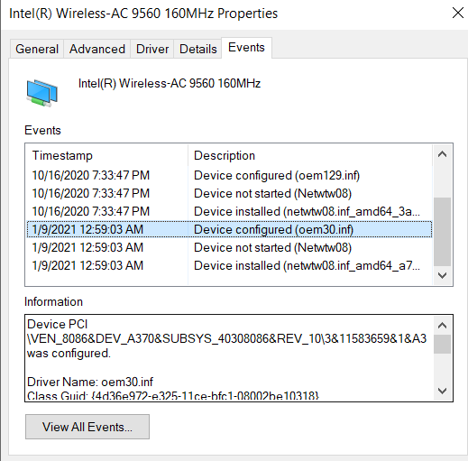

- Looked up the log under the Properties of the eth card. Doesn't show any events since October (screenshot below) till yesterday (9th Jan) which is when I updated to the latest Intel drivers.

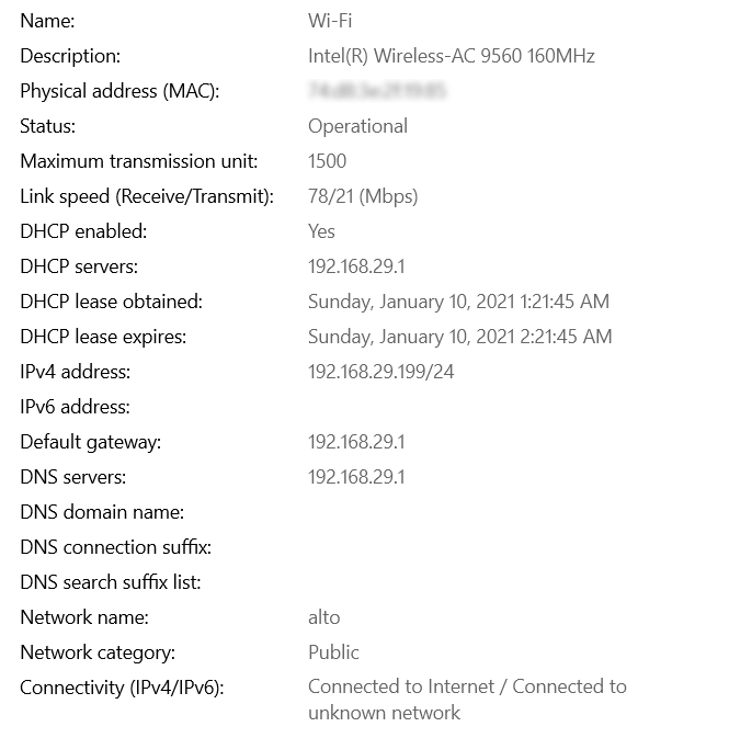

PS. Can anyone notice anything off in the screenshots below with config details? e.g. THe Link Speed as 78/21, isn't that low?
