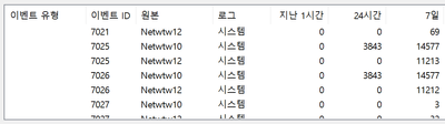

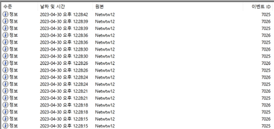

From the event viewer, it goes like this.
Every a few seconds, it makes info log with Event ID 7025 & 7026.
And in about every 10 minutes, there are error logs with Event ID 5002 & 5005.
And sometimes, warning log with Event ID 6062.
Also, randomly info log 5032, 7002, 7010 & 7017.
(I attached the event log)

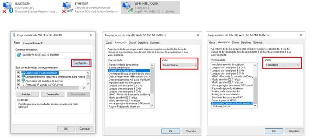

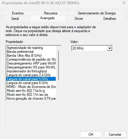

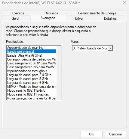

Well, since no one from support can explain or find a definitive solution. After searching on the internet, I found some comments and came up with the following solution to this problem on my machine, and since then, I haven't had any Wi-Fi issues.
I went to the network card properties and made the following adjustments.
If it doesn't work, try configuring it with other bands. See attached screenshot.

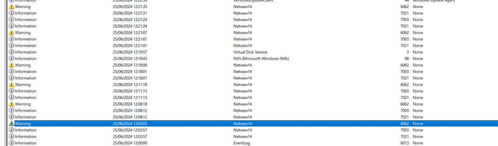

I am having the same exact issues with all the errors and am convinced it's what's causing a critical BSOD crash daily.
JGFMK
47,522 Views
These events are also appearing in the Event Viewer in a combo of 2 info, 1 warning for netwaw14 too.
Recurring System Event_IDs 7021(Info),7003 (Info), 6062 (Warning)Recurring System Event_IDs 7021(Info),7003 (Info), 6062 (Warning)
Network Adapter is Intel Wi-Fi BE200 320MHz - on a Razer 18 (2024). See my posts here.
I rolled system back to Factory settings twice, and looked at shipped driver vs the one with Intel Software Component 2408.5.4.0
I made sure no Windows updates for cumulative packs or drivers were installed.
I get a BSOD stop code: DRIVER_POWER_STATE_FAILURE
if I download the Intel Software Component 2408.5.4.0 then apply the cumulative Windows monthly update 2024/05 or 2024/06.
Update 1:
I think this issue may be down to Nakama MP (a multi-player platform service). I use Paradox Interactive with both a PS5 and PC.
See this post.
Update 2:
Today Intel provided me an update. Be sure to check this out. It seems to have fixed my constant Stellaris disconnects.
https://www.intel.com/content/www/us/en/download/19351/intel-wireless-wi-fi-drivers-for-windows-10-and-windows-11.html
Use the 'get started' button rather than the download if the series of Network Adapter Driver doesn't correspond to your system.
After running the exe, be sure to reboot. I got no BSOD this time around. Looking good so far - longest period I've been able to play Stellaris unimpeded by logged out messages.
