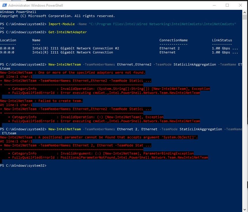

I too have done a clean install of Windows 1809 build 17763.316 and my MSI MEG creation X399 AMD motherboard but unlike you and getting no joy on a clean install with no previous "Intel® Ethernet Adapter Complete Driver Pack" installed orders windows itself install those previous packs like 23.5 or 23.5.1?
I've included an image below of my power shell failed installation and as you can see the "New-IntelNetTeam" get a "potential parameter cannot be found that accepts argument" error so I'm not sure what caused that issue.PowerShell 1809 Error.jpg I've gone back to 1803 thinking that 23.5.2 driver still haven't been fully investigated by Intel and pastors okay but now reading your comment I'm wondering if windows 1809 itself installs 23.5 or 23.5.1 which I hadn't previously thought was installed and needs to be

@MinionBR​
Thanks, looks like my team member names​ where wrong, lol, powershell needs more explaining as youtube videos show "connection name" : ethernet, ethernet 2" can be used but your use of "name" : Intel(R) I211 Gigabit Network Connection, Intel(R) I211 Gigabit Network Connection #2 shows it should be used instead.

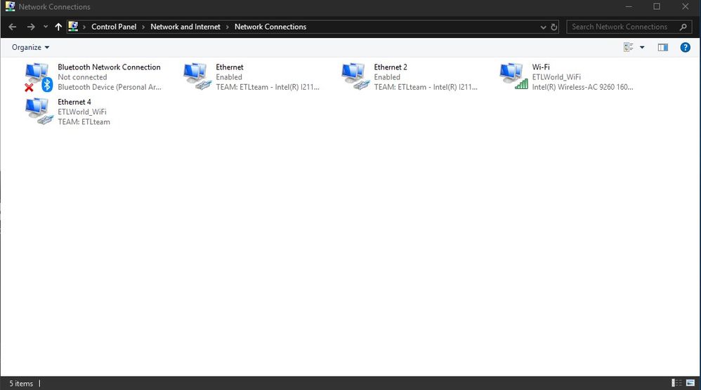

@ALest2​
OK tried it with success. For me it was the correct naming convention issue. Also my Netgear Switch LAG needed to be setup first which meant that my NIC's connections were funky/broken so I went with "WIRELESS" connection to set up Powershell.Success Teaming 23.5.2.jpg
