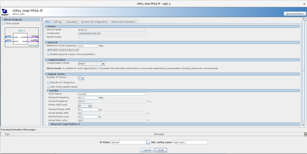

I am using IOPLL Intel FPGA IP for Aria 10 SoC device. I need a clock of 307.2MHz/30.72MHz with a ref Clock of 10/100MHz . How can I get the exact clock?
ABhus
2,557 Views
With many possible combinations as well, I could get Actual output clock as 307.5M/307.142M/307.189M but not exact value. M,N,C Counter values can be edited only as integer values but not fractional values. Please suggest what can be done.

ABhus
2,528 Views
Thanks for the response.
Actually, in IOPLL there is no option to set PLL mode as Fractional mode.
But there is one fPLL under Transceiver section in which we can use Fractional mode.
Is it ok to use fPLL for driving user logic?
When I tried using fPLL it is giving Fitter placement issues as shown below?
"Error(11215): Input port "REFCLK" of "CMU_FPLL_REFCLK_SELECT" cannot connect to PLD port "O" of "IO_INPUT_BUFFER" for atom "fpga_clk~input". "

ABhus
2,527 Views
Hi Eng Wei
I am using Quartus Prime 19.1.0 and Arria 10 SoC Device.
For PLL IP Selection, Basic Functions -> PLL -> IOPLL Intel FPGA IP as shown in the image attached.PLL_selection.PNG
For Parameter settings for IOPLL, please refer attached image.PLL_parameter_selection.PNGAs per this, I am not getting fractional calculation settings.
Could you please check these snapshots and revert.
