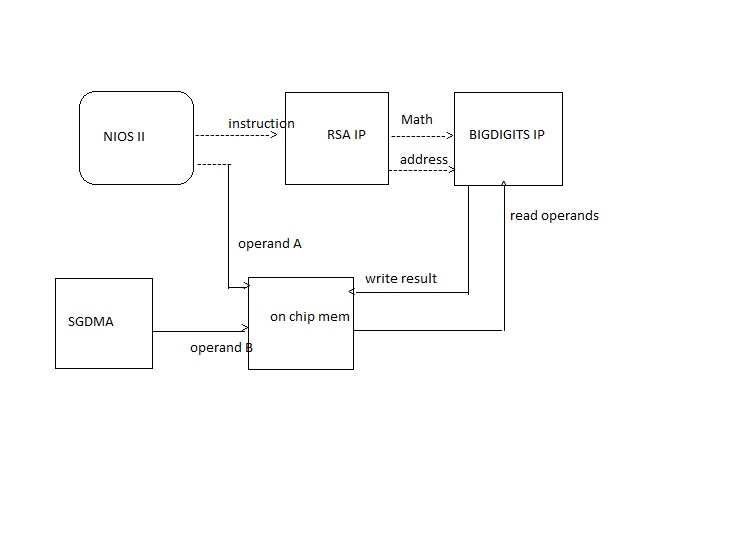

Thank you for the explanation, Ted! Glad that I met you here who knows how to explain clearly, for a beginner in Quartus II like me.
So I am just confirming the tentative design to make sure we on the same page. Please see the attached diagram which shows the entire design for a typical RSA application.
The NIOS II core uses the RSA IP core to implement the RSA in hardware. The RSA IP core talks with the BIGDIGITS IP core to get the desired bignum functionality.
The control path will be from NIOS II -> RSA -> BIGDIGITS. And as you pointed out, the BIGDIGITS will have a custom instruction interface for the control signal to increase the speed. The functionality of that custom instruction is, output = input. It just passes along the address (for both the operands) and the 'opcode' to perform for the BIGDIGITS.
The data path will be from the on chip memory to the BIGDIGITS IP core.
Hope the above design is an okay one for me to start implementation in Qsys (I need to learn that as well, huh ! I had so far been an SOPC guy.)
Thank You,
Akhil

Your block diagram looks OK. The bottleneck is going to be the "operand A" path from NIOS to onchip memory. I'm not familiar with the specific algorithm you are implementing: is "operand A" going to be generated from the body of a nested loop, or is it going to be generated only once (as an input parameter) before the algorithm/loops execute?
Altera_Forum
1,091 Views
Hello Ted,
The operand_A path and operand_B path to on_chip memory is just a tentative design. I can implement an RSA algorithm which generates the two prime numbers (operand_A and operand_B internally (the RSA IP core can take care of that). Just in thoughts of a future enhancement (the thought that BIGDIGITS IP should be an IP core that can be used with any application which can accept two input operands to use) I plan to use the data path.
And as you pointed out, that might be a bottleneck. However I do not need to clock in the operand_A from the body of a nested loop. In fact, I plan to clock-in the data before the algorithm/loops execute. Also please note that if I need to clock-in 1024 bits of data, I need to do that for 32 clock cycles, 32 bits every cycle.
(also please cross check that my understanding of the custom instruction is correct, i.e, the way it passes the addresses to the BIGDIGITS IP core)
Thank You,

--- Quote Start ---
Hello Ted,
--- Quote End ---
OK, yes in reality your system will likely have additional components as well and they will all fit into the shared 32-bit address space seen by NIOS and SGDMA. It looks fine.
--- Quote Start ---
--- Quote End ---
Yes I believe you have got it correct.
Good luck!
