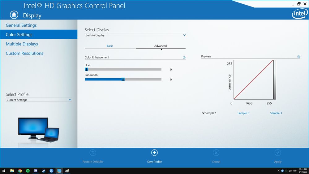

Hey,
I have a laptop with a secondary screen and I would like to know why i cant use digital vibrance in the second one,instead i have the YCbCr option.
Thanks a lot.
( In case of need I'm using a Lenovo Y50-70 Touch with a 4600 HD integrated driver)

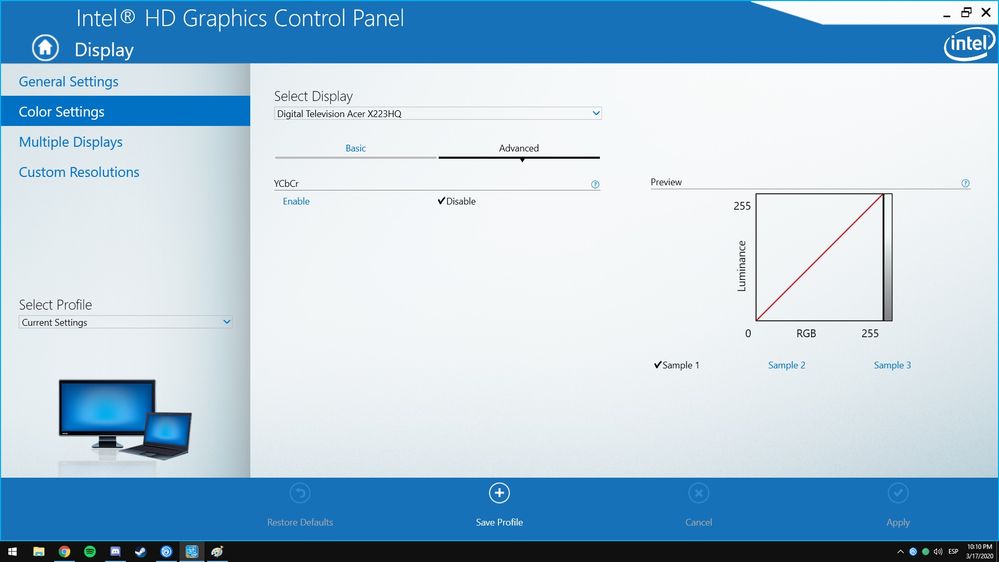

Actually I'm using my external screen as the primary one ( Multiple displays - Single Display - external monitor ( in this case Acer X223HQ but i have tryed with more screens )
-Which video port are you using to connect the external display?
As i said in the upper question i have tryed different screens with differents options,actually I'm using a VGA connector but i have tryed DVI and also HDMI
-Are you using adapters or converters?
This is the first time I'm using a converter that is HDMI-VGA ( i have used HDMI-HDMI and HDMI-DVI and still had the same issue )
-What is the application that you have where it shows the YCbCr option instead of Digital Vibrance?
Intel HD Graphics driver version 20.19.15.5107
-You said the problem only happens on the secondary screen, could you please provide the steps that you follow to activate the Digital Vibrance on the embedded monitor?
So..this is the deal,if I use Extended desktop or Clone Dispays option provided by Intel HD graphic panel control Digital Vibrance would only work on Laptop screen but not in the external one.Right now I'm using only Single display ( external one ) and the option that appears on Color settings is Ycbcr.

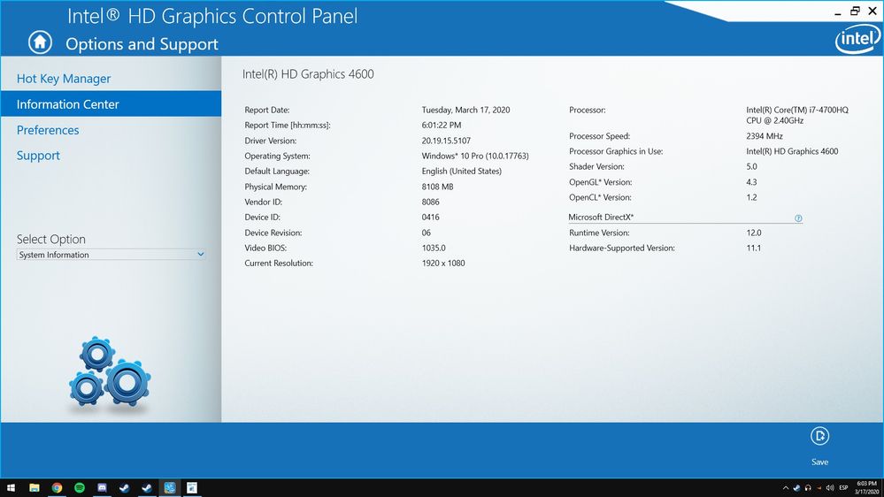

CAbre1, Thank you very much for sharing that information.
Based on the pictures, we can confirm that in fact, the laptop is using both graphics controllers, they could be switchable or hybrid and the thing is that it is hard to tell which of them is the one supporting the external monitor, that is why we need the SSU report and the graphics report.

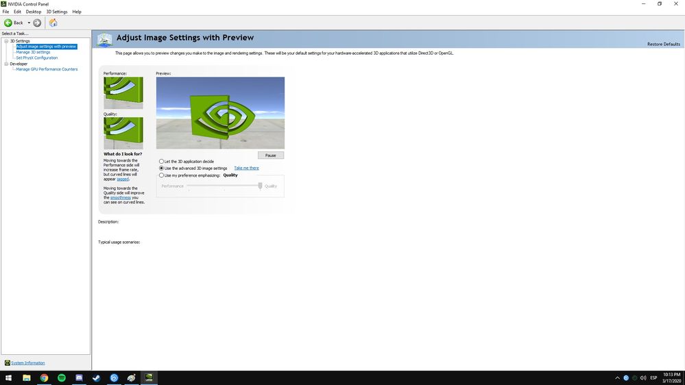

Just to make sure, when you enabled the Digital Vibrance feature, are you doing that in the Nvidia control panel, could you please share a picture of that?
In the picture of the Intel® Graphics control panel that you gave us, on the lower-right corner you will see that it says "Save", please select that option to save the report and then attach it to the thread along with the SSU report.

CAbre1, Thank you very much once again for providing the pictures and the Intel® Graphis Report.
In reference to your comments, the "Digital Vibrance" feature actually belongs to Nividia, however, there is a feature that might be related or it might have a similar function as "Digital Vibrance" in the Intel® Control Panel called "Saturation" as you can see in the picture you posted previously.
Based on the Intel® Graphics report, I can see that the build-in display is supported by the Intel® Graphics controller and the External Display connected to the laptop through HDMI shows up as "Inactive" that could be also the reason why the option for "Digital Vibrance" is not available.

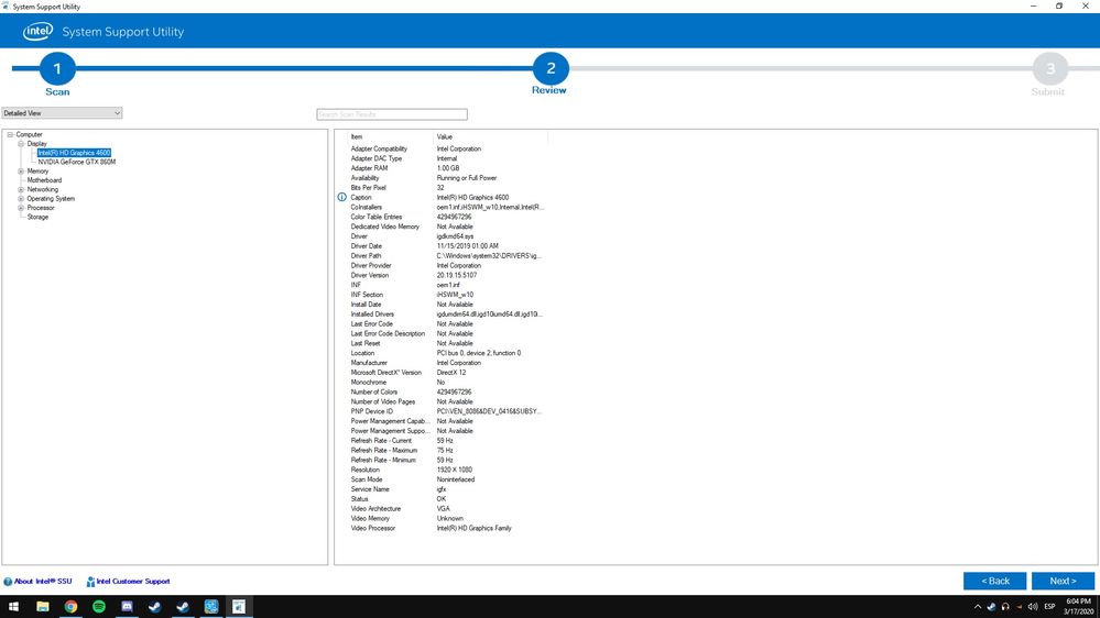

Oh I'm really sorry it has been my mistake,when i said Digital Vibrance i meant Saturation ( Digital vibrance was never shown it was my error )
File's been attached

CAbre1, Thank you very much for providing the SSU report.
Based on the information showing the links below, it states that the monitor that you are using supports VGA and DVI graphics interfaces, it does not support HDMI and it is a TN (Twisted Nematic) display, so basically the monitor does not have the option to support "Saturation"
https://www.acer.com/ac/en/US/content/professional-series/monitor-essential
https://icecat.biz/en/p/acer/et.wx3he.a01/computer+monitors-x223hq-3467130.html
In this case, we recommend to get in contact directly with the manufacturer of the monitor to verify if it actually supports the feature of "Saturation:
