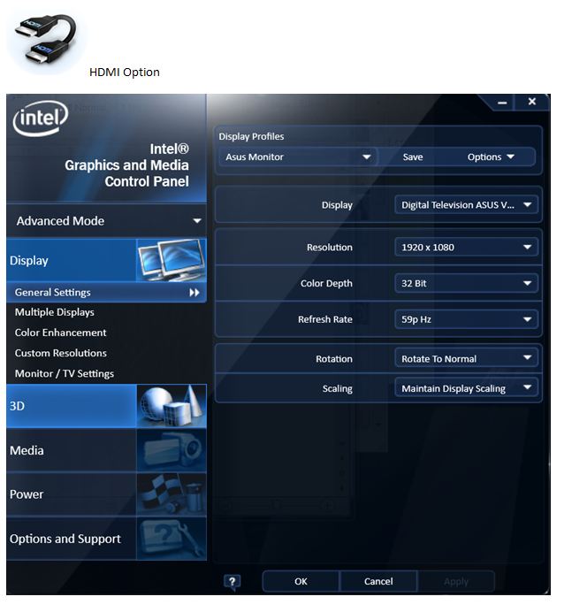

I have an Asus Zenbook Ux31A (Intel 4000 HD) and I'm having a similar issue. Asus tech support is also completely useless, so don't even bother with them.
So this is my issue. The Micro HDMI to HDMI connection doesn't work with my Asus external monitor, but the VGA connection works fine. However, when I update the driver, my computer finally detects the HDMI connection and the external monitor. If I restart the computer (which you are actually supossed to do after the update), or even Hibernate, it no longer detects the monitor and I have to reinstall the driver. This doesn't make any sense because the driver is still installed. However, it does confirm that my cable works, the hardware works, and in theory, the computer and the monitor can communicate with one another.
The other unique part about it is typically, I can toggle between LCD, CRT, and CRT + LCD. However, after installing the driver I get 3 new options (HDMI, LCD + HDMI, CRT + HDMI). When I pick HDMI, everything works fine. When then check my Graphics settings, it finally recognizes that I have an external monitor, though it seems to think its a Television instead of a monitor, so that might be part of the issue. Regardless, if I restart my computer, it seems to forget everything and I have to once again reinstall the driver. I hope this is enough information to go on. I included a screenshot below of A) What the HDMI toggle option looks like and B) what my graphics settings look like when its functioning properly.

Ashrit Kamireddi- same thing with my zenbook. as i stated before, there is an easier way to make the hdmi work. go to the device manager and disable the hd4000, then enable it, it will start working untill the next sleep/reboot 😕
it's messed up but, at least we can make it work a little bit.

Hi Mish and Ashrit Kamireddi, I have exactly the same product (Asus UX31A) and the same issue (late vession 8.15.10.2761) and I will probably make a short-cut doing what you say. But I'm very disappointed about the support of this driver : a large number of complains are around the Internet about the same issue and none of Asus nor Intel are talking about it. The last update of the driver is 5 months old... Hopping they will finally come back to work after this loooong holiday!
