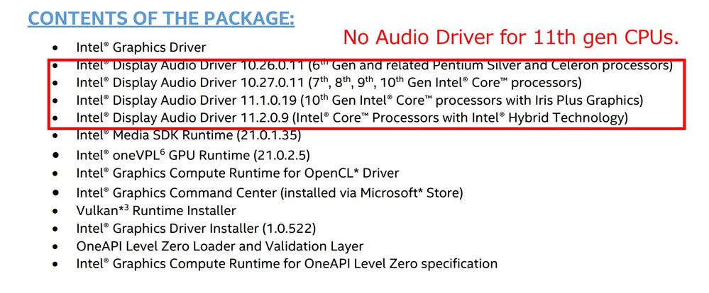

  • I found that both Intel and Asus drivers seem to use the same Microsoft driver files:
  • Intel's driver release note says it does NOT contain Audio Driver for 11th Gen CPUs:
  • I searched the Internet and I believe this problem is caused by so called "silent stream bug", but Intel's datasheet for 11th Gen CPUs claims that they still support "silent stream", but how?11th-cpus-datasheet.jpg

Hello ap2112,
In this case, we have checked the release notes of the driver and we can confirm that the latest driver support 11th gen processors.
Also, please share with me the following information:

Another point is as I mentioned before, no matter what version of driver (Intel/Microsoft/Asus, Stable/beta) I install, the “Driver Details” button in Device Manger always list the same files from Microsoft, and their version is 10.0.22000 which is exactly the same to OS version number.
Intel’s graphics driver package only provides an inf file (MSHdaDac.inf) which tells the OS to use the “universal” Windows built-in HDA driver files.
Based on above facts, is there a possibility that HDA device comes with Intel 11th CPU does not have a driver from Intel, but uses OS supplied universal driver which does not provide “silent stream” functionality?

The thing is, as @RonaldM_Intel mentioned in this thread:
"has Intel removed Display Audio support from the Core 11th Gen and 12th Gen CPUs or is this just a driver issue?" - the answer is YES
Currently the driver should be relying on the MSFT Inbox ACX DAC.
So currently no matter what version driver I install,  as long as I use the same Windows 11, the Display Audio driver always uses the same version of " MSFT Inbox ACX DAC".
I would appreciate it if you can give an answer to "Does the audio driver emit silent stream or not?"
