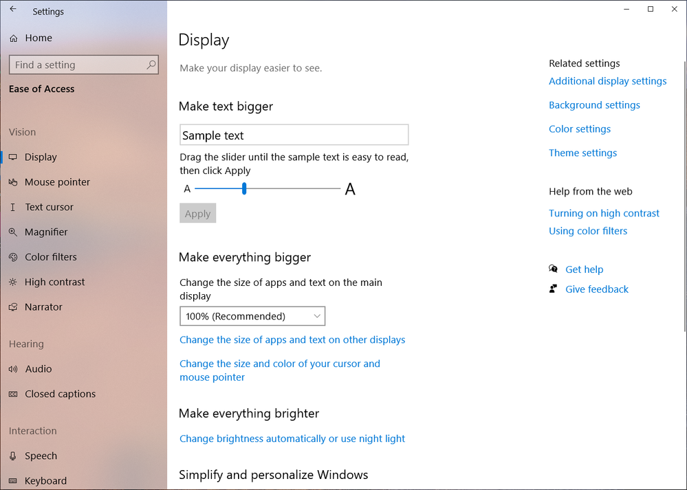

  1. The correct way to enlarge text id doing this from Easy of Access in Windows Setting, rather than with scaling (see the attached image).
  2. Your laptop is equipped with NVIDIA GeForce GTX 1050 Ti video adapter (which should be the main graphics adapter). Please verify that the NVIDIA Graphics Adapter is enabled in BIOS. In some cases, in order to enable the additional graphics adapter, the Intel Integrated Graphics should be disabled.
Leon
