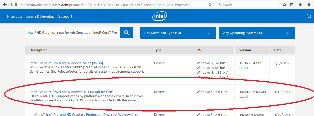

Hi everyone,
I just wanted to let you know, in case it helps, that I have found a driver that switched my screen back to normal, and I have no eye strain problem whatsoever. It is not much older than the latest one by the way. Apparently, I had not noticed that, even if I installed an older driver, Windows 10 would upgrade it to the latest version shortly afterwards. I needed to "Change device installation settings" from the Control Panel in order to stop this from happening. (perhaps the version which I tried a couple of days ago would have worked too)
So now I have downloaded the file win64_154010.4300.zip directly from Intel (not my laptop vendor) and did a manual driver installation (the corresponding .exe installer is not allowed to execute on my machine, due to a driver update policy or something). This is the resulting "good" driver version:
The latest version available for my machine, which is normally installed automatically by Windows 10 and causes me problems, is this one:
It's interesting that it's just one version increment that causes the issue in my case...

Can you share, how do you download these drivers? I went to intel.com website to search for intel's graphics driver for my Lenovo T450 laptop that has Intel 5500 graphics (Windows 7), and the search gives no result.

Kray_62
Thanks! It is quite a relief indeed!
I got the driver from the download center (see image below). If you start typing "intel hd" in the search box, it proposes you various relevant searches. Read through the driver details carefully however, once you find one, to make sure that it fits your system. Also, you might have to download the zip file and install the driver manually, after removing your previous one, instead of downloading an .exe version (assuming an exe version is available, of course). In my case, as I have mentioned, the .exe would refuse to proceed due to some rules set by my vendor, if I have understood correctly.

_dimitri_
No wonder. I searched Lenovo T450 graphics driver and nothing came up. 🙂 Will try searching using the right keywords like you suggest.
