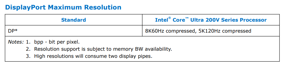

3840 x 2160 @ 240 Hz = HBR3 DSC 11 bpp ... OK
Please connect the laptop to the monitor with one of these cables:

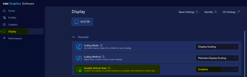

Use the monitor's On Screen Display (OSD) to set the following:
  • Function Key Guide  MUC_1-1737384918554.png  >> Game >> Adaptive-Sync >> ON
    • Picture-in-Picture (PIP) Mode must be disabled to activate AdaptiveSync
  • Function Key Guide  MUC_1-1737384918554.png  >> Game >> Refresh Rate >> 240 Hz
Make the desired settings in the Intel Graphics Software, e.g.
5 Replies

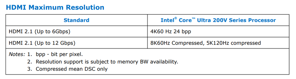

Intel Core Ultra 200V Series Processors (Lunar Lake) generally support HDMI 2.1 FRL with a maximum bandwidth of 48 Gbps.
Whether this is also available on the physical connector of the device depends on the implementation of the Original Equipment Manufacturer (OEM = ASUS). Unfortunately, I cannot find any data from ASUS that clearly states whether the connector supports HDMI 2.1 TMDS (max 4K @ 60) or HDMI 2.1 Fixed Rate Link (FRL).

edit: I did ask, they replied that it supports 4k/2k 60hz (they do not mention the actual HDMI spec, probably it's not documented for customer support?). Well it seems that it probably is TDMS.
Thank you for your time, I didn't know there are multiple HDMI 2.1 standards.
