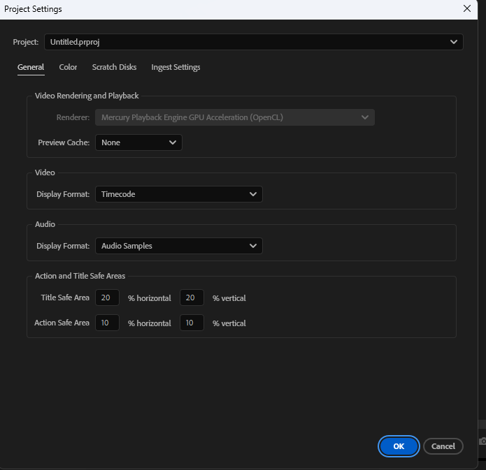

im use last 2 year  arc a 750 and im waiting for full primire pro optimize driver when i running adobe primire pro and after effect when im render my video my cpu use 100% not full gpu use and make slow
im use  Intel® Graphics Driver 32.0.101.6790 (WHQL Certified) but still not solve problem premire pro and after effect

me download my  Adobe Premiere Pro in creative cloud
Adobe Premiere Pro settings me attach sreenshoot
 the temperature of my CPU and GPU while on load the cpu 65 and gpu 51
 the new BIOS that was installed no any change in my rendering time
me attach my render time sreenshot

To address your concern, we utilized an AMD Ryzen™ 7 5800X Desktop Processor paired with the Intel A750 graphics driver, following the settings and steps you provided. While the processor used in our testing is slightly more advanced than your Ryzen 5 5600, the results should offer a close approximation of your experience.
During our tests with both the 32.0.101.6881 WHQL Certified graphics drivers, we did not encounter the issue where the processor takes up most of the workload. This suggests that the latest driver version may resolve the problem you are experiencing.

USER0071212
364 Views
This issue was reported to them in January, and we communicated with them on the forum for two months without resolving it. After updating the latest driver today, I suddenly found that the hardware acceleration of PR can be used normally. The compatibility test of Intel graphics card really shocked me.
