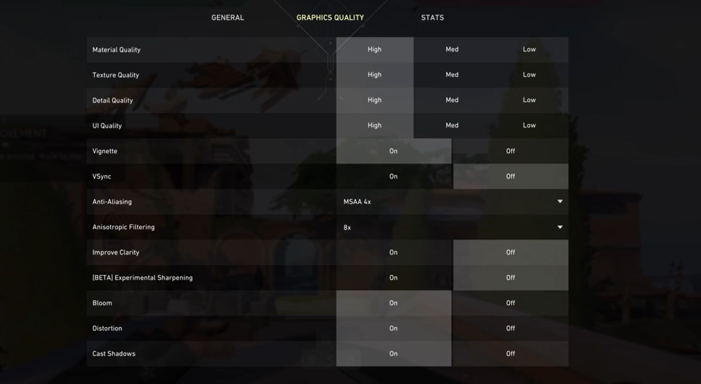

I have it turned on. When I put my gtx 1660 i have multithread and low latency, but when I install my predator bifrost arc a770 16gb oc I dont have that option available. My cpu is i5-10400f

We want to let you know at the moment we have been able to reproduce this issue after trying to enable "Multithreaded Rendering" in the in-game settings the option is not showing up. We passed the information to the corresponding team so once there is an update on this problem we will let you know.

After carefully reviewing this issue we believe that the game makes a validation of the system components to display the available graphics settings. There might be a game limitation when the game is detecting the Arc GPU. We tested the game as you can see in the screenshots attached when using an Arc GPU the multithreaded rendering option is not available but there is another option "Experimental Sharpening" which is not available for Nvidia graphics.
Due to the above reasons we recommend that you contact the game developer directly for further troubleshooting, in case the issue cannot be resolved from their side, please open a new thread so we can further assist and just reference this one.

After further checking this problem with our team we determined that the support for multithreaded rendering in this case the availability of the option since the GPU should be able to handle multithreaded rendering, should be implemented by the game developer. We apologize for the inconvenience.
We will now proceed to close this thread, feel free to open a new topic if you need further assistance.
